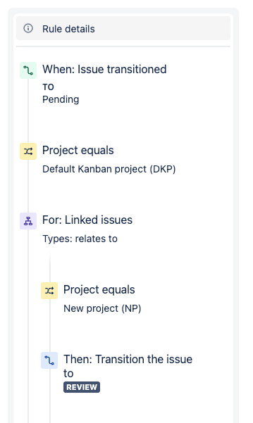

Hi @Sreedevi Raman Pisharody
Why don't you accomplish this with Jira automation.
If have made a simple example that should do the trick.
Sreedevi Raman Pisharody July 26, 2023
@Marc - Devoteam
Did you mean Automation for Jira Plugin, If yes I could not find the plugin available for Jira Server version.
Our instance of jira is currently running on Jira Server version and is likely to migrate by start of next year only, hence unable to use Jira automation.
I can't look into your wallet, but you should switch to a Jira DC license or migrate to Cloud.
Jira Server is EOL and support stops on Feb 2024 completely. I hope you are aware.
Since Feb 2023 its not possible anymore to license Atlassian owned plugins from the marketplace, if you didn't have the plugin already.
On the script I can't help you further, as I don't have scriptrunner in my system. It's a bit to expensive for personal use and with automation included I can do most actions with it,
