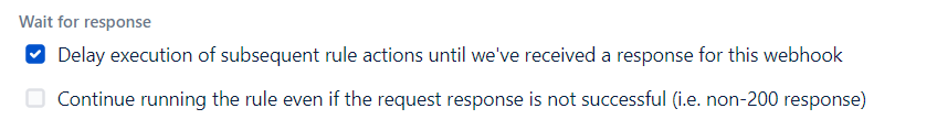

By the way, there was no need to check the "Delay Execution..." checkbox (at least for my needs).

Make sure to check the following checkbox:
Let me know if that will solve your problem!

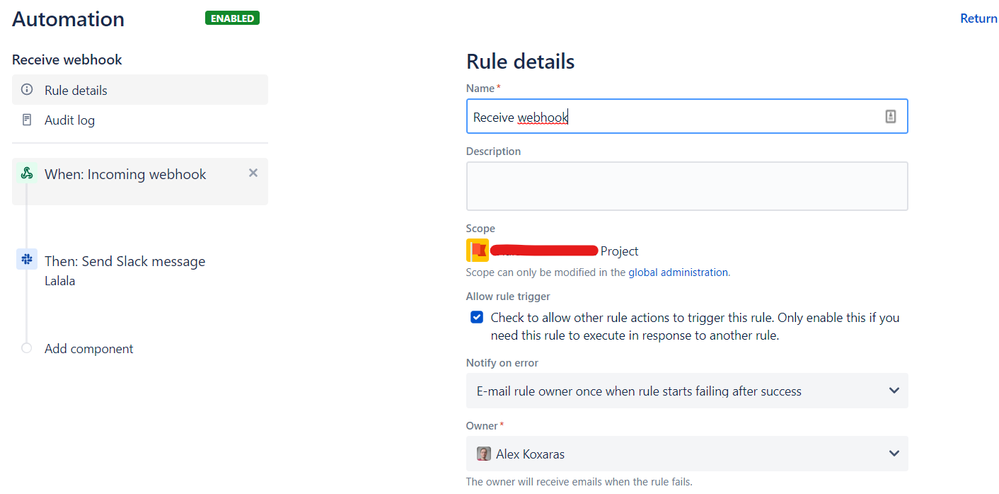

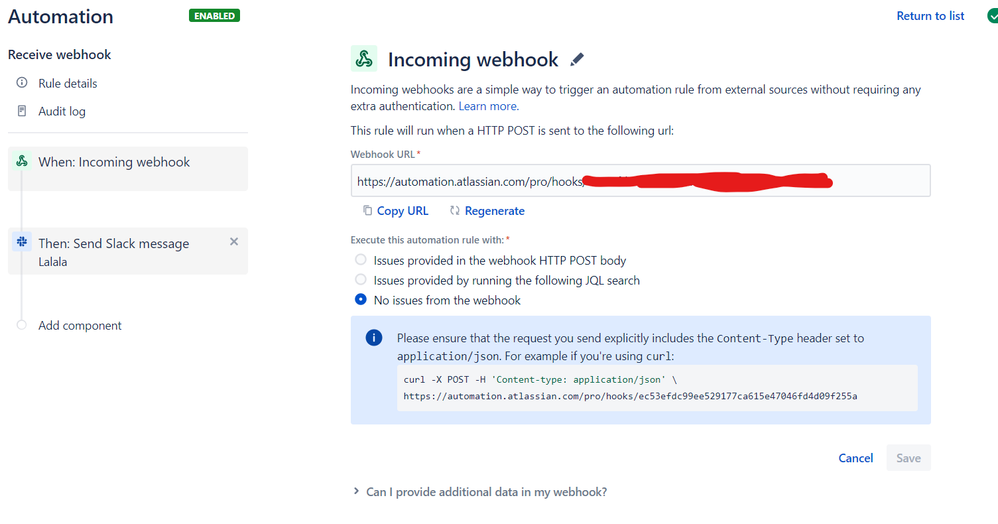

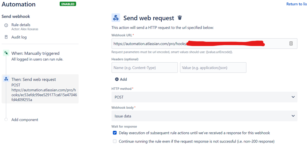

Hi @Aviram Raiffer ,
Take a look at my implementation, which works. I have created two rules for you, and named them properly to distinguish them. Rule A is Send Webhook and rule B is Receive Webhook.
RULE A: SEND WEBHOOK
RULE B: RECEIVE WEBHOOK
Details
Incoming webhook
Although my rule, in term of actions, is pretty simple, following the same setup would end up to fire Rule B.
Can you share your rules?
