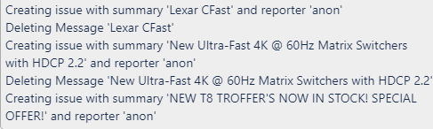

From what I can tell, everything is set up correctly, and when I 'Test' is shows the test was successful. When looking at the details, it shows 346 messages were read from the server at 10 issues were created. However, when you look in the details further, it also shows that not only was an issue created, a message was deleted.
Is the test supposed to create real issues/tickets? Because it is not.
In addition, when I send a test email to the email specified, no ticket is created.
What am I missing and/or how can I troubleshoot this?
My test log works:
However, is it really supposed to create an issue? Because it is not.
I've also sent several test emails to the email address (set up in the servers) - but have not seen anything being created or done.

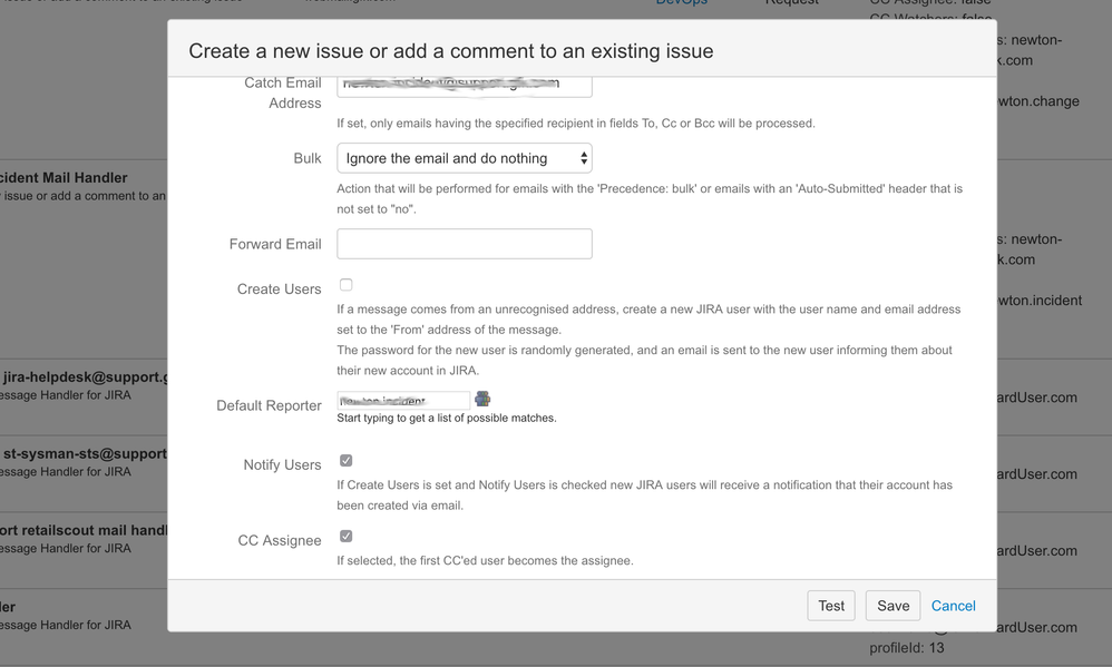

Can you share (using some screenshots etc.) the mail handler configuration as well as the permission scheme in use of the project?

If you use the default mail handler, than i would suggest to set up a "service account" that has all needed permissions and to configure this one as the default reporter within the mail handler config

The default reporter is someone else, as the email address being used to try to create the email is used by several people.

Service account is meant as an generic - technical - account only used to create issues in case that the sender can not be mapped to an existing account (you could also think about the create user option within the mail handler to create accounts for unknown users send mails to your instance)

the steps that need to be taken (like having that generic account as default reporter)
Pls. have a look
