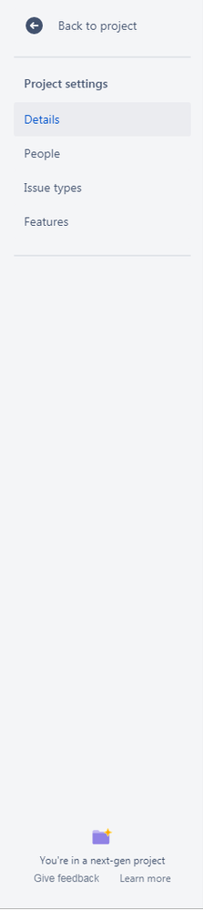

yeah,  no.  I'm telling you...every single piece of documentation I've seen gets me to a place that either doesn't exist in my project for some unknown reason or I do what it says and don't end up with the one thing I am trying to do.  I watched the video, tried things in it and don't get expected results.  I don't even have these menus at around 16:06 I don't even have workflows in my project settings as described in that video.
Michael Kuhl {Appfire}
August 12, 2019
Ok, if the menus don't appear in the project then it seems like you are a Jira Admin, but you are not an admin for that project.   Access the project via the Admin->Projects link. It might look different depending on the version of Jira you are using.
Then click the Project settings link for the project.  Once you are in the project settings assign yourself the project admin role and verify that role has Administer Project permissions for that project and the menu items should then be visible.
Brian Conlon August 12, 2019
And I realize now too that this issue somehow ended up in Jira and not Next-Gen.
August 12, 2019
There's the reason:  You are using a next-gen project type.  You cannot customize workflows in a next-gen project.
