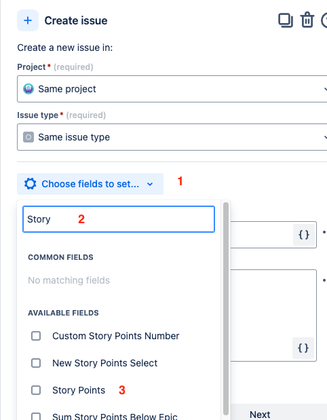

To set the Story Points field in your Create Issue action:
1. Click the Choose fields to set... button
2. Type Story into the search field. This should reduce the field list to a set that includes Story Points (3)
4. Check the box next to the Story Points field that should be displayed in the result set.
5. This should move the field to the Selected Fields section at the top of the pop-up with the box checked.
6. Click somewhere in the white space of the Create Issue dialog outside of that field selection box.
7. That should make the field selection box close and you should see the Story Points field displayed in the Create Issue dialog.

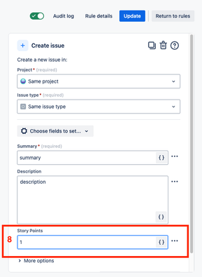

8. Type a 1 into the entry field below Story Points

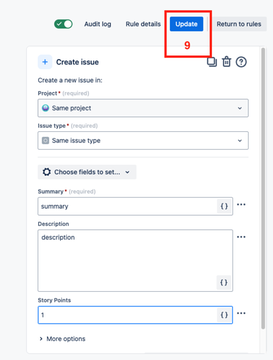

9. Click the Update button above the Create Issue action dialog to save the change to your rule.
10. Execute the actions that cause the rule to run.
11. Review the new issue created. The Story Points field should show a "1" in it.

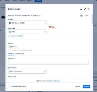

12. Lastly, rather than trying to manually edit the field in an issue created by the rule try manually creating such an issue from scratch.
12.a. Click the Create button.
12.b. Select the same Project and Issue Type referenced in the rule.
12.c. Do you find the Story Points field in that dialog?
12.d. Enter a value in that field, complete all other required fields, and save the issue. Then review that newly created issue and confirm that the Story Points field has the value you entered.
