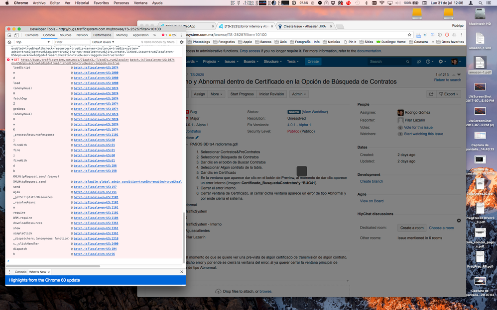

I'm on an issue (I have tried with 3 or 4 different ones, although all on the same project), then I click on the More button, then Link. The screen goes a shade darker, and a smaller rounded black square is displayed. This same transition is visible when doing some other actions, but the small square "grows" to the input screen. This doesn't happen on the Link action.
I have cleared Chrome cache, restarted the server, used another browser (Safari, I am on a Mac), upgraded Jira, reindexed, and nothing changes.
When the small black square is displayed, if I press "Esc" then the screen returns to normal, i.e., apparently there is some input screen displayed, but with no data visible.
Here is a screenshot of said square.

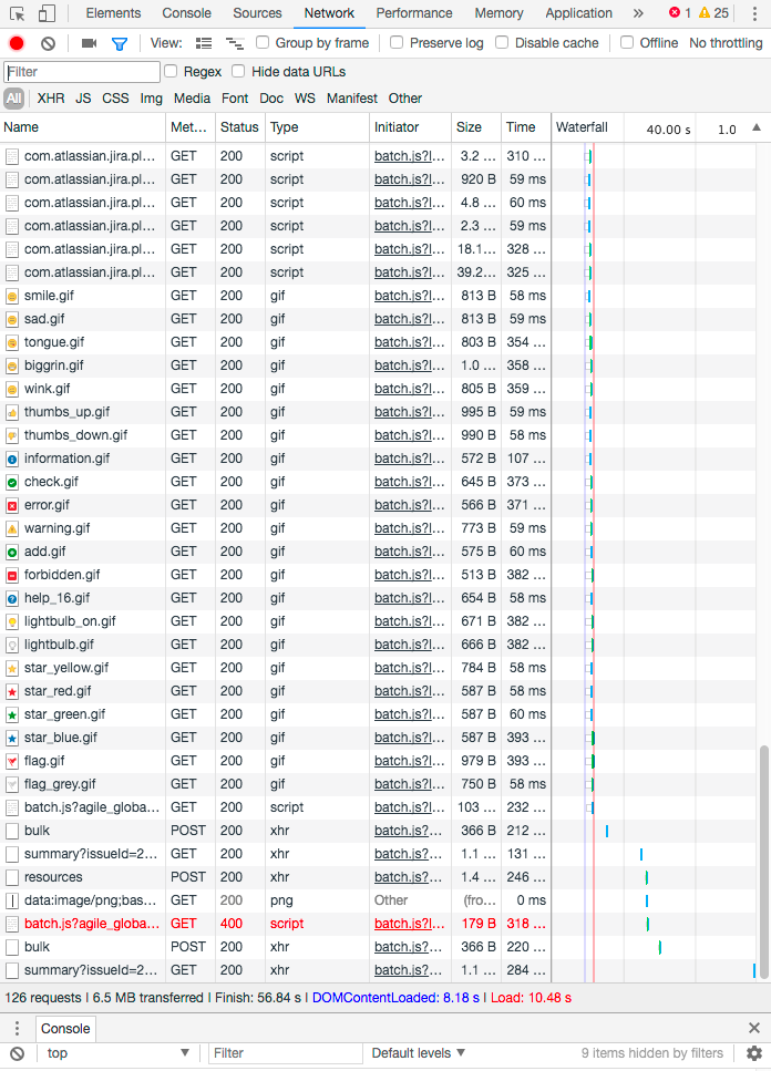

For the record, I'm posting some more screenshots from the debug tools in Chrome.

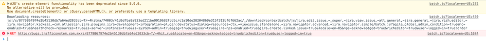

could you provide console log errors, warnings from web browsers.
For example, in google chrome just press Ctrl + shift +c, and click console tab. Hence we can understand a conflict.
Here is a screenshot of the console after Reloading the page, clearing the console, and pressing the Link button:
The text of the console is the following (I couldn't post it as it triggered some spam detection and I couldn't post the Reply)
Comparing the request that fails (the one using the ISAPI redirect) and the same request but not using the redirect show some differences:
