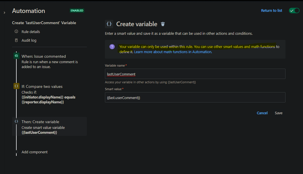

So I did end up writing an automation to create a variable 'lastUserComment'...
However, I can't figure out for the life of me how to utilize this new custom variable. It sounds like I need to create a new custom field within the relevant workflow configurations (which would be all my workflows I believe), however when I do so I can't find a way to insert my custom variable into the new custom field.

After you create a variable, you may use it in the rule just like any other smart value. From your screen image, that would be {{lastUserComment}}
I note where you are setting the value, you changed the syntax a bit. Didn't you want the actual comment? Something like:
{{issue.comments.last.body}}

I appreciate you helping to clarify that the Variable is the value I can use outside of this particular automation rule.
As for the Smart value, I was not aware that the name I set for it was anything more than a name, just like the Variable name.

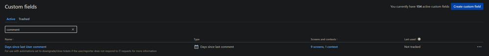

So if I'm understanding you correctly, I would then replace 'updatedDate' from the JQL in my rule in my first screenshot with '{{lastUserComment}}'. The thing is though, when I use the brackets, the button to validate my query becomes greyed out, and when I delete the brackets, I get an "Invalid JQL" error saying that the field 'lastUserComment' does not exist or I do not have permission to view it.
Is this because I also need to create a custom field to store this new variable, and insert it into the Request forms for all Issue Types in all Projects I'd want to utilize this functionality?

First thing: created variables only exist within the rule where they are created. They do not exist outside. What I meant was you can use it only in that rule.
Next, the JQL you mention which uses a smart value cannot be validated *at design time* in the rule editor. That is why that validate button is disabled.
I think you are on the correct track that if you need to check the last comment and the last commentor (person/user), you could store that in a custom field for use later in the other rule. For example, by saving the last date/time the reporter commented.
