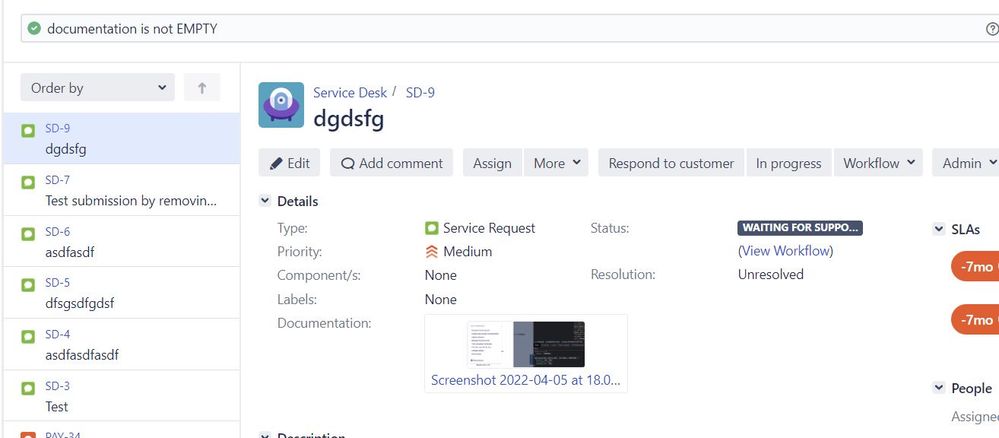

1- Yes, you can filter issues with or without attachments, using IS EMPTY or NOT EMPTY in your JQL:

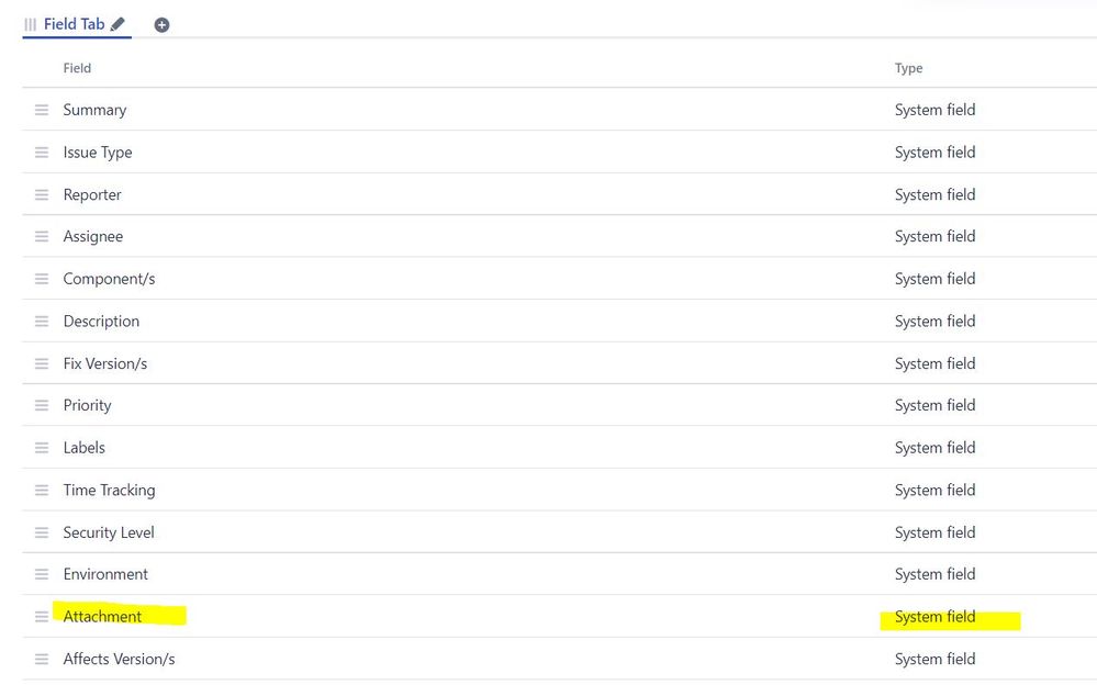

2- Yes, you can do that by updating your issue screen
