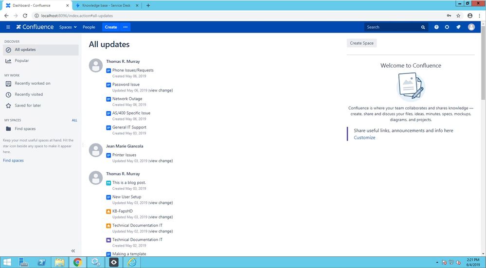

I have since originally posting this, found that ther are two services for Confluence in Windows, and when I shut the one down, the old 8090 Confluence DB is gone. My issue now is trying to link the second install of Confluence to this Jira SD. But when I try to choose Confluemce in "Project Settings" of the SD project, it says "We're having trouble communicating with the application. Wait a minute and try again." but waiting does nothing. I'm assuming it's looking for the application on the original port 8090. I'm looking around for documentation on how to change the default ports for my second installation of Confluence (while stopping the original trial versions service).

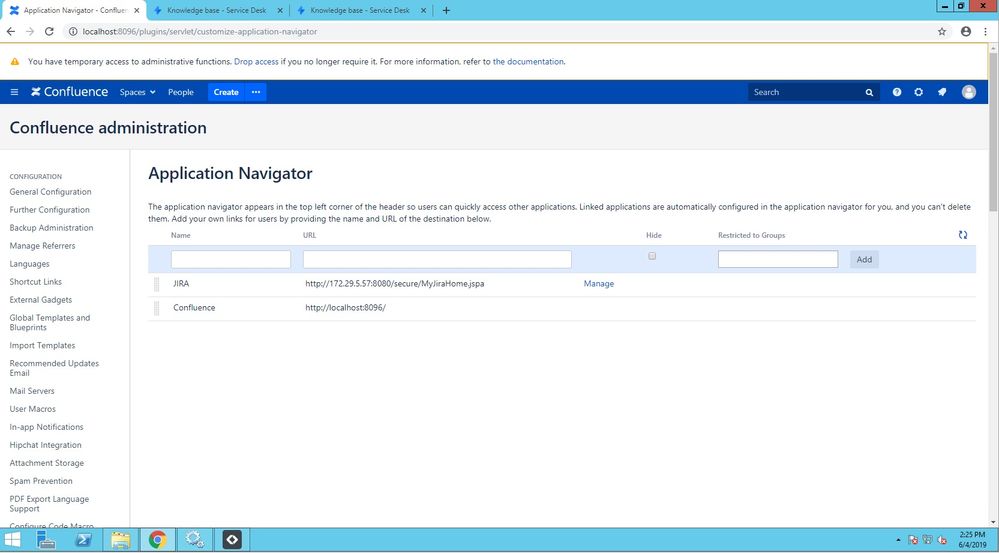

Moved it along I think. This is what I'm showing right now, and I'm wondering how to make this right.
