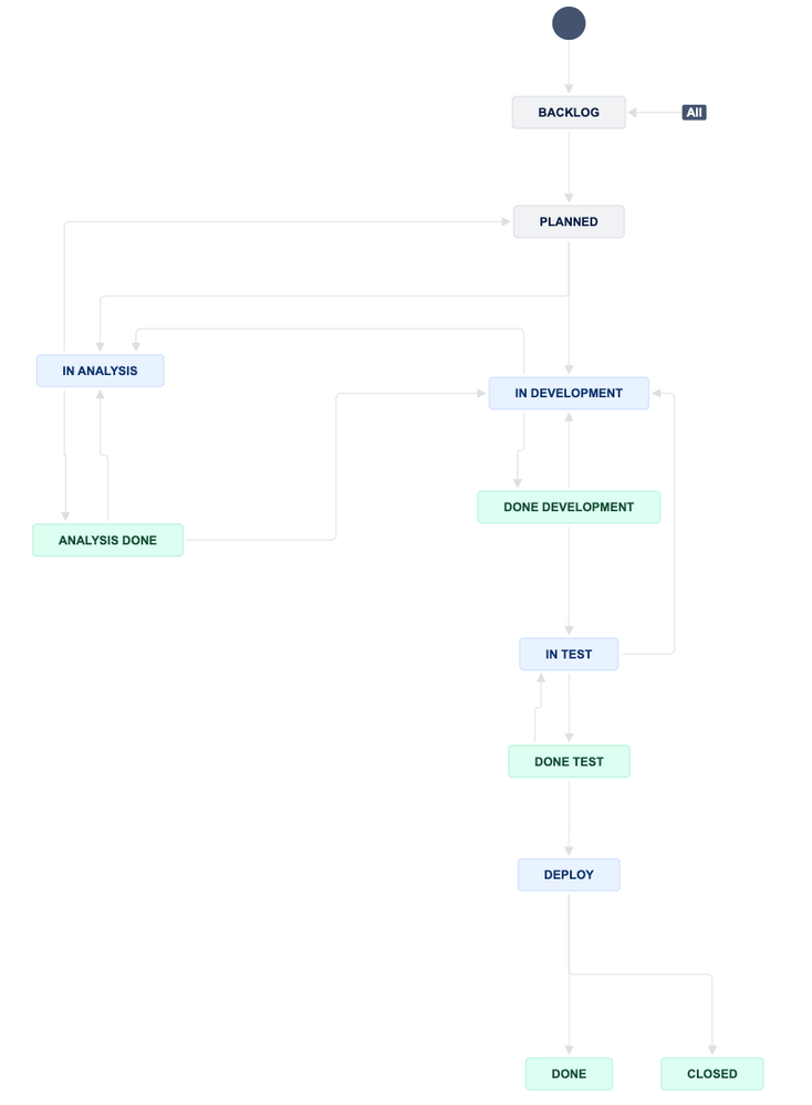

My workflow is as following:

Are you saying that you can transition from Planned into Analysis Done directly on the issue, but not from the Kanban board?
If so, that seems very strange, as I don't see a transition from Planned into Analysis Done, so I'm not sure how you could do it from the issue.
If, however, you're saying that once the issue is in "In Analysis", you can transition into Analysis Done from the issue but not the board, this also doesn't seem to be expected behavior, as transitioning the issue directly from the View screen isn't any different than transitioning it from the Kanban board. In that case, I would double check your board configuration to make sure that all of the columns/statuses are mapped appropriately.

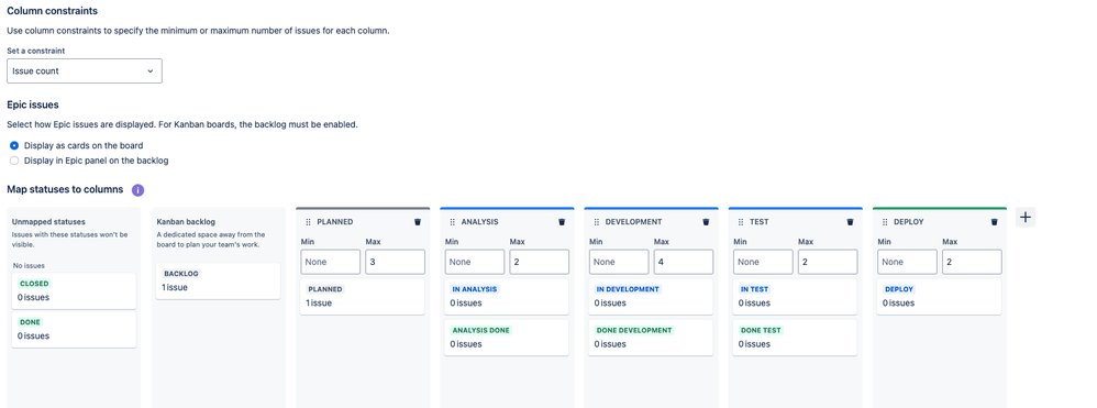

At the moment my columns and statuses setup in Jira are as this:
Ok, I understand what you're saying now.
Unfortunately, this is expected behavior. If the two statuses exist in the same column on the board (which it sounds like "In Analysis" and "Analyis Done" do on your board), then you can't transition between the two statuses on the board. Transitions are only allowed on the board if the source and target statuses are mapped to different columns.

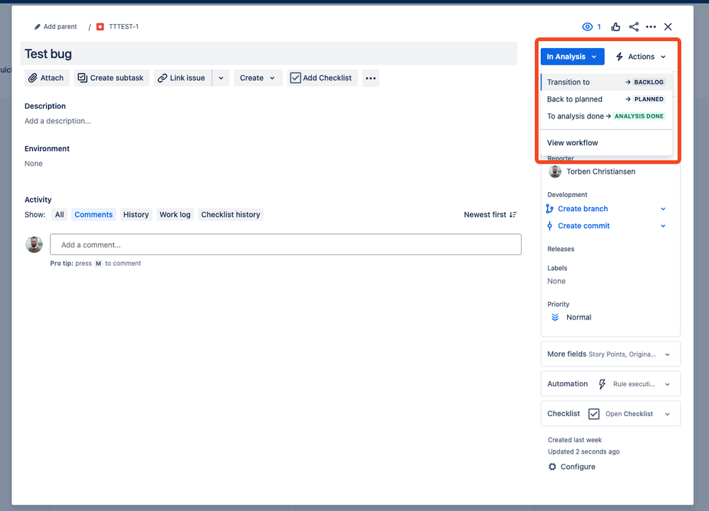

But just so I fully understands; I can still make a task transfer from "In Analysis" to "Analysis done" when open the task right?
Like this:
Yeah, as long as the transition is allowed in the workflow and you meet all of the conditions (if any) on the transition, you can always transition the work item.
