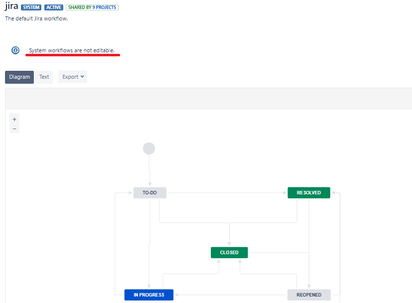

"To-Do" seems to be the default, non-editable "jira" system workflow (see image:Jira Default Workflow.png).

1) are both of these true, non-editable system defaults?

  1. No, one of them has been added by someone.  Although they might both be new - you can rename the default status to something else.  I tend to avoid doing that though.

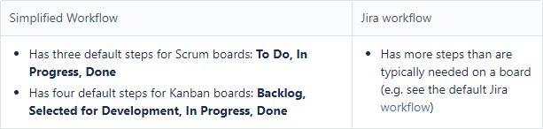

However, I'm still worried about deleting this "To Do". My issue is that using the simplified workflow feature will reintroduce "To Do" into my environment after I go through the trouble of deleting it. Here's the bit from the above link that concerns me:

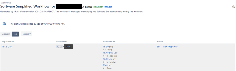

Moreover (since I know that snippet form the article is just talking about steps which are a little different from statuses) when I go to one of the Software Simplified Workflows in our instance the "To Do" status is the one that's being used! See:

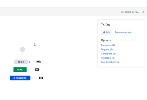

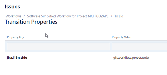

Some more information - when we go to change one of these Software Simplified workflows I also see a property on the all transition to the bad "To Do" that seems to be there by default, I don't know if that clears or muddies the situation:

Yes, removing a duff "to do" will not stop it being re-introduced by a project admin later amending a simplified workflow.  This is a bit of a training matter for project admins - you have to persuade them to re-use existing ones as much as possible, and, bluntly, tell them that if they don't, you will remove their duplicate ones without warning, and it will be their fault all their reports stop working.
When you simplify a workflow though, this will not create it with new "to do" status, it takes the existing ones.  It's only admins adding new ones you need to be concerned with.
The property on the to-do status is for translations, which is a slight bonus over a custom status.

I'm a little unclear still on the property and if we need to carry it over to avoid breaking these workflows. Can you elaborate on what it's doing?
And how will the Software Simplified Workflow know which status to use instead of the faulty "To Do".

The property is purely to allow for translations, if you miss it, the translation won't function.  For example, if you've told Jira to show "Machen" if someone has selected German in their profile, then if you remove the property from it, the Germans will see "To Do" instead.  And you can always put it back!
You can't delete a status while it is part of any workflow, so you will need to edit the workflows currently using the bad one, flipping the status on that step over to the one you want to keep.  Once it's no longer used, you'll be able to delete the duff one from the list.
