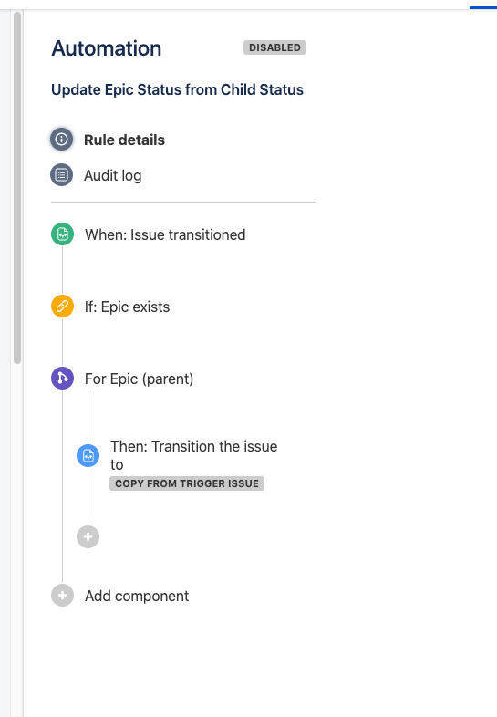

If your child issues and your Epic issues share the same statuses, then you would create a rule that looks like this:
(Caveat - I have not actually executed this rule in my environment, so I can't guarantee that it works)
You would probably want to activate that rule only for the affected project. If there is more than one, be aware that the Standard plan for JIRA has a limit on how many rule executions can happen in a month for rules that apply to more than one project.

Upon reflection, I think there will need to be a bit more sophistication in the rule. Since you have the conditions of
NOW - any child issue is in progress
FUTURE - all child issues are completed
you would need to make the rule a bit more sophisticated so that the Epic would not move to FUTURE until all the child issues are done. The basic rule I presented would move the Epic to FUTURE when any of the child issues are set done. Similarly, if a child issue changed from In Progress back to To Do, you wouldn't want the Epic moved back to LATER unless all the child issues were set to To Do.
You'll have to invest a bit of time in figuring out how to implement that.
