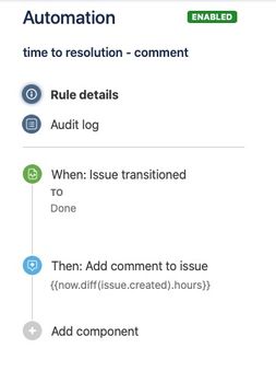

Ok, so let me first provide this disclaimer - I have not tried this and therefore cannot provide a definitive solution but I believe it could work for you.
Given you are on cloud you may be able to accomplish your goal using the built in Project Automation. Here is the concept:
If you feel this might work and try it, please report back w/ your final solution as other readers could benefit. If I get some free time I may give it a go and will do the same, likely thru an article in the Community.
update: my quick test proved successful. Here is the basic test i did...
Obviously, you will want to adjust the automation and use of custom fields to achieve you precise goal but it does work. I plan to write up an article on this in hopes that it will help others.
