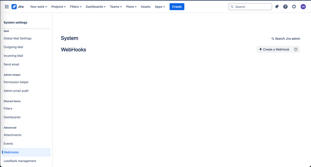

I am currently facing an issue where I am unable to see any webhooks listed in the Jira Config Dashboard. However, I can successfully get, delete, and create webhooks through the API.
Here’s what I have tried so far:
  1. Verified that I have Jira administrator permissions.
  2. Verified API access by running GET /rest/webhooks/1.0/webhook, which returns the webhooks correctly.
  3. Tried creating a new webhook via the API, and it works fine.
  4. Looked into third-party apps that might interfere with webhook visibility.
  5. Checked audit logs for any deletion or configuration changes.
Despite these checks, I still cannot see the webhooks in the admin dashboard.
Has anyone faced a similar issue or knows how to resolve this? Any help would be appreciated!
Mohanraj Thangamuthu
May 18, 2025
Hello, Good day. What happens if you directly access the following URL.
https://sitename.atlassian.net/plugins/servlet/webhooks
Also have you tried accessing from different web browser?
