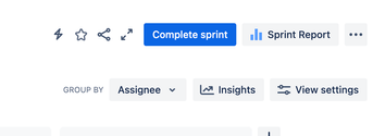

I've been trying to recreate your issue.
I saw only those options when I had a scrum board instead of a kanban board, but I haven't been able to recreate that on a Kanban board yet.
Can you double check that there is not a Complete Sprint button in the upper right corner of the board (indicating it is a scrum board)?
Eléonore Dixon-Roche July 25, 2024
Oh my gosh there is... and it's not on other boards I have. Is this a setting that I can change and/or if select "Complete Sprint" does that just clear the Done items? Thanks so much for helping!

Hello Eleonore,
Are you familiar with Scrum vs. Kanban agile methodologies?
With Kanban you are working against a steady stream of prioritized incoming work. With the Kanban boards you can use the Clear Done Issues option to clear the done column.
With Scrum you create a time-boxed Sprint and add to the sprint only the work that you are committing to completing within that time period. At the end of the time-box you specified, you use the "Complete sprint" button to tell Jira you are officially ending the sprint. Jira will pop up a message telling you how many issues were completed and how many were not. It will ask you what you want to do with the incomplete issues - put them back into the backlog or add them to another sprint.
With the Scrum methodology you keep making time-boxed sprints, adding work to them, completing the work and closing the sprints.
So, the question you need to first answer is do you want to be using the Kanban methodology or the Scrum methodology for this project?
For a Team Managed project you can switch between them by disabling or enabling the Sprints option under Project Settings / Features. When the option is disabled the board works in the Kanban manner. When the option is enabled the board works in the Scrum manner.
If you want to change to Kanban for this board, change the Sprints option. Then you will get the Clear Issues option in the Done column.
If you want to keep working in the Scrum manner, then you will need to use the Complete Sprint button to end the sprint and clear the Done column. Then you will need to keep making new sprints, adding work to them, starting the sprints to show the cards on the board, and completing the sprints to clear the Done column.
Hi Trudy,
This is incredibly helpful. Familiar with both methodologies, just inherited this board yesterday and didn't know how to flip between the two.
Good to go now, thanks again!
Eléonore
