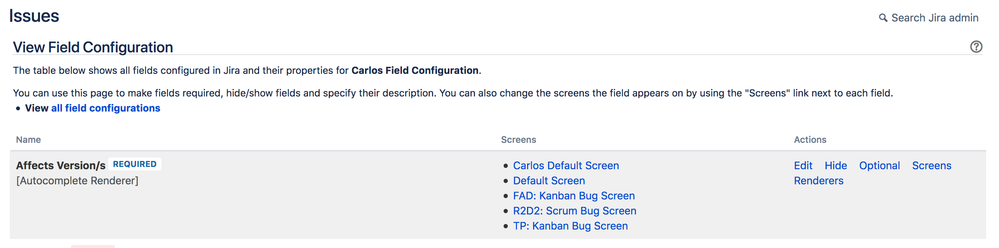

Thanks for the info, Sheri. Do you see a label indicating 'required' in the field configuration associated to your screen?:
Carlos
