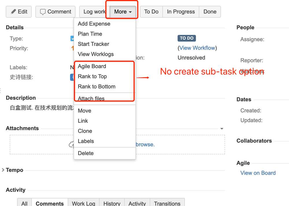

Unable to create subtasks for all issue types (Epic/Story/Task)
I tried the Field Configurations and Screen Configurations but didn't find a place to configure it.
How can I enable or restore this feature back?

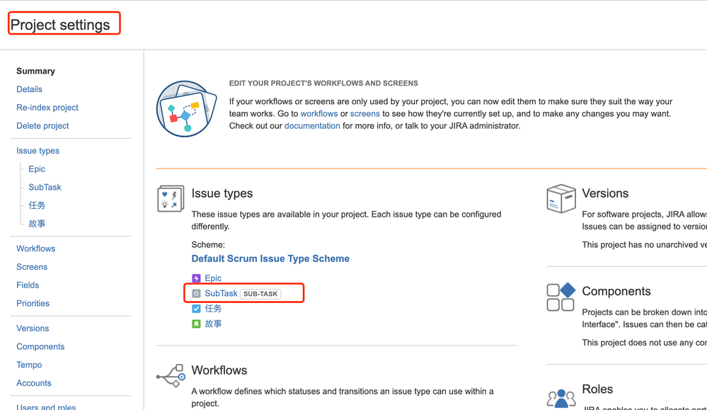

I checked Project settings .The subtask issue type exists in the issue type scheme associated with the project (as shown in the screenshot below)

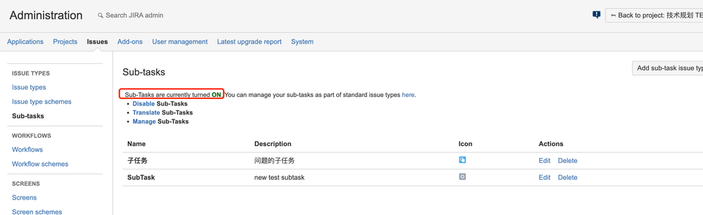

And Sub-tasks are enabled in the Sub-Tasks administration page

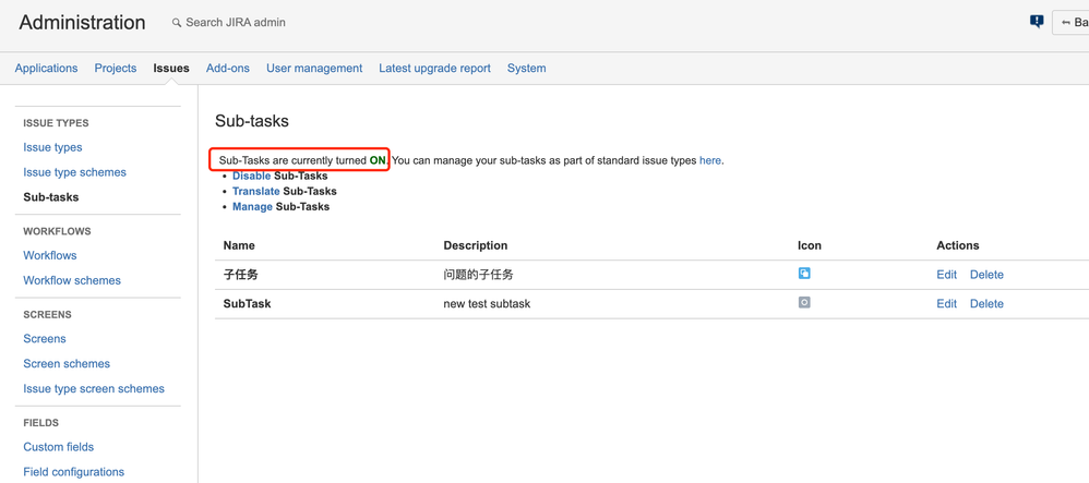

It could also mean that an global administrator has globally disable subtask
https://confluence.atlassian.com/adminjiraserver/configuring-sub-tasks-938847874.html
Hope this help
Hi @Florian PEREZ [Valiantys Administrator]
Thanks for detail page for enable sub-task.
I checked Sub-tasks are enabled in the Sub-Tasks administration page(screenshot below))
