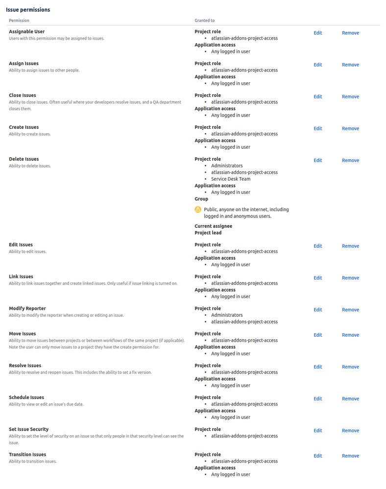

this is the permistion we gave for Delete Issues
Project role
         - Administrator
          -satlassian-addons-project-access
          -Service Desk Team
Application access
           - Any logged in user
Group
           -Public
           -anyone on the internet
           -including logged in and anonymous users.
Current assignee
Project lead

Can you try using the UI and tell us if it's ok or not  please.
amit_lodhi December 26, 2019
Sorry,
there is no delete option in UI.
This is  screenshot for permission or UI
Screenshot_2019-12-27 Edit Permissions - Jira.pngScreenshot_2019-12-27 [TP-107] Fri Dec 20 05 25 00 IST 2019(CPU) - Jira(1).png

You really need to cut that permission down to "admins only" - at the moment, the entire world might get access to delete anything they want, and deleting in Jira is very very permanent - you won't get it back.
Can you tell us what licence level you have for your Cloud system?  And what "type" of project this is?
