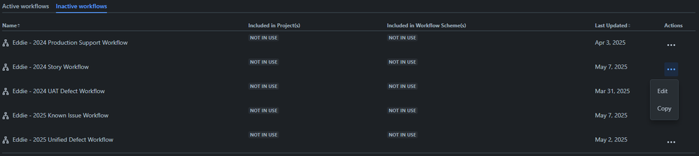

I have a workflow that's no longer useful but I'm unable to delete it. It's not associated with any project, nor is it associated with a workflow scheme. Other similar workflows that are also inactive can be deleted, but not this one. Any ideas?

Eddie Hobart May 7, 2025
The Story Workflow is the issue. The rest that you see there all have the delete option in the menu.

Weird - I certainly can't duplicate the problem.
But here is my suspicion - the workflow is indeed associated with a Scheme, but the scheme hasn't been published.
So go to the list of Schemes  - both Active and Inactive and see if the workflow is listed for any of them. Also, look for the icon of the i with a circle around it - that might be the scheme in question.
Very strange.
There are several workflow schemes that have the circled "i" icon, but they have nothing to do with the workflow in question nor is the icon interactable.
If I search for the workflow across all active and inactive schemes it doesn't appear.
John Funk
May 7, 2025
Start with those with the icon and publish them or delete them and see what happens.
Eddie Hobart May 9, 2025
Found the issue. Someone else added that workflow into an unpublished scheme for an unrelated project. Deleting that draft solved the problem.
