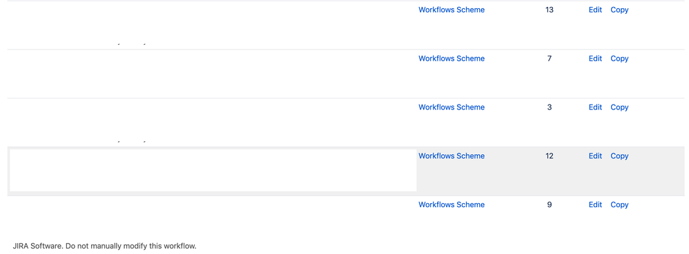

Screen Shot 2019-06-26 at 11.46.40 am.png@Nic Brough -Adaptavist-  I have removed the name of the workflow and the workflow scheme name from the screenshot. This list exist in the inactive workflow list

Guy Geron
June 26, 2019
@Nic Brough -Adaptavist- I think I might have gave you the wrong screenshot. Can you please explain to what line you're referring to?
June 26, 2019
No, you have given us exactly what I asked for.
It tells us your workflow is definitely in the <obscured> Workflow scheme.  Next thing to look at is that workflow scheme list and find that workflow scheme in the list.
