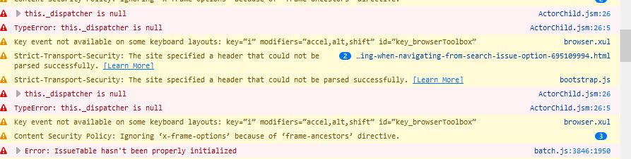

Ash
January 16, 2019
@Tuncay SenturkThanks for your reply. This is what i see
Tuncay Senturk
January 16, 2019
We're getting closer.
These javascript errors might be related with an app which may not be supported by your Jira. Anyway, you can try disabling apps one by one to locate the problematic app.
Hope it helps
Ash
January 17, 2019
This is what I'm seeing in chrome. Enabled safe mode on plugins still no luck.
Tuncay Senturk
January 18, 2019
Ok, I think you're facing a similar issue with this.
  • Go to admin > Manage add-ons
  • Select All add-ons from the drop-down so that system add-ons would be listed.
  • type browser metric to filter text, and see Jira browser metrics integration plugin.
  • Disable that plugin and test again to see if the problem is related to this plugin.
By the way, are you facing the same issue for all browsers? Or just Chrome?
Ash
January 18, 2019
@Tuncay SenturkThanks for your response.
This is happening in all the browser.
After disabling the plugin i don't see any errors in the browser console. But issues drop down is opening finally with a very slow response after clicking on the icon.
This is issues is not happening for everyone but only a particular user who has so many filters.
Thanks.
