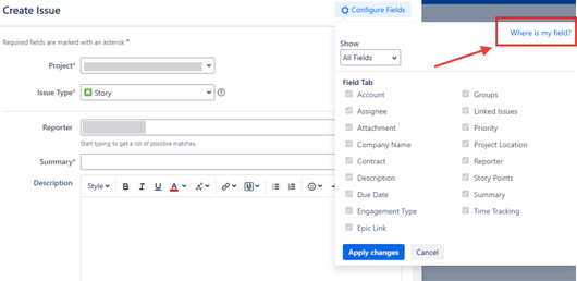

I noticed that in your images from your rule the Project you are specifying for the Epic creation is not the same as the Project that you are showing in the Creat Issue dialog screen images.
Can you share an image of the Create Issue dialog for an Epic in the same project you are targeting in your rule?

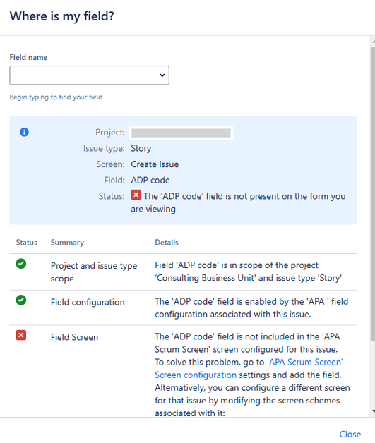

From the error message, it seems there might be an issue with the fields. When you use the "Where is my field?" feature to search for the desired fields, does is it say that all fields were found? I believe this could be a good starting point to investigate the problem.
