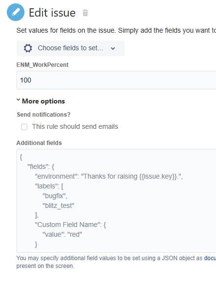

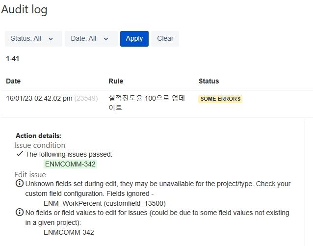

×In my case, I am trying to update value to a number field. Can you advice for me?

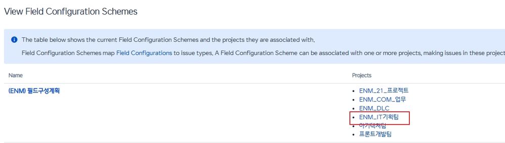

JIRA Agent user has a administrator role, and the custom field is in a field configuration scheme of this project and screen of this issue type.

It's probably because you're trying to set the ENM_WorkPercent Field twice in the Action - once from the Field selection box, the second in "Additional Options"
Remove one of these two - if it's just updating it to "100", clear the "Additional Options" section and close it, and just keep the direct field value add at the top of the Action
If ENM_WorkPercent is a Number Field, you also don't need "100.00" - 100 will work just the same way.
Give this a go, and let us know if it works!

Hi @jun lee
Have you checked this field is available for the relevant Project/Issue Type you're trying to use it on?
I would check the...
This is assuming it's a Company-managed Project - if it's Team-managed, is this field available on the Screen?
Ste

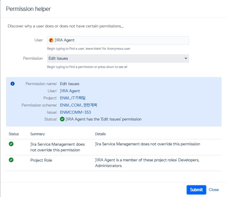

Hi @jun lee
Does the user "JIRA Agent" - which you've set as the Actor - have permission to modify these Issues?
Ste
