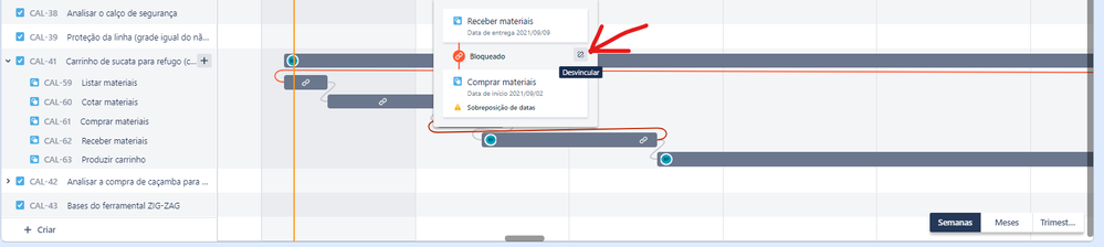

Good morning everyone.
Our team is using the timeline to create a project, but after having linked a subtask to another, it no longer unlinks, even clicking on the button it "blinks" as if it had unlinked, but then links again in less then one second. We've already removed the dates and put them back in, but once the date is re-entered, it automatically re-links each other again. Anyone know how I can detach from each other? We have the free plan at the moment, but maybe after this project I will be able to convince the directors to pay Jira.
Thank you very much for your attention.

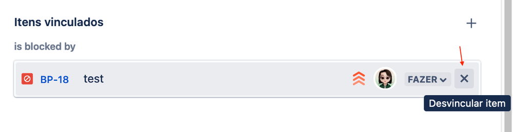

Have you tested removing the linked issue from the ticket instead of the timeline? Does it work?

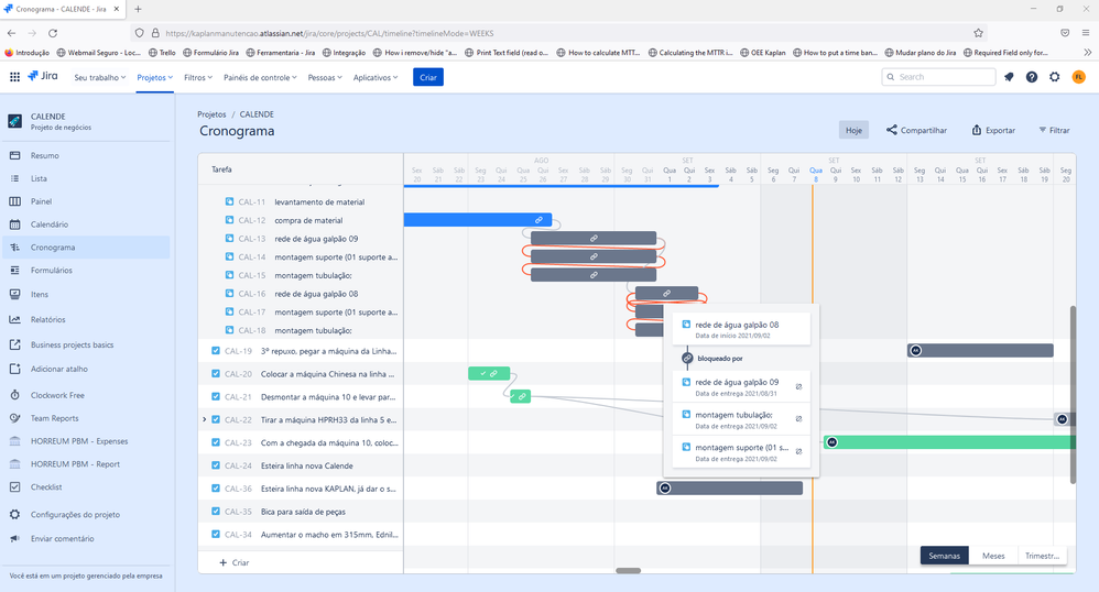

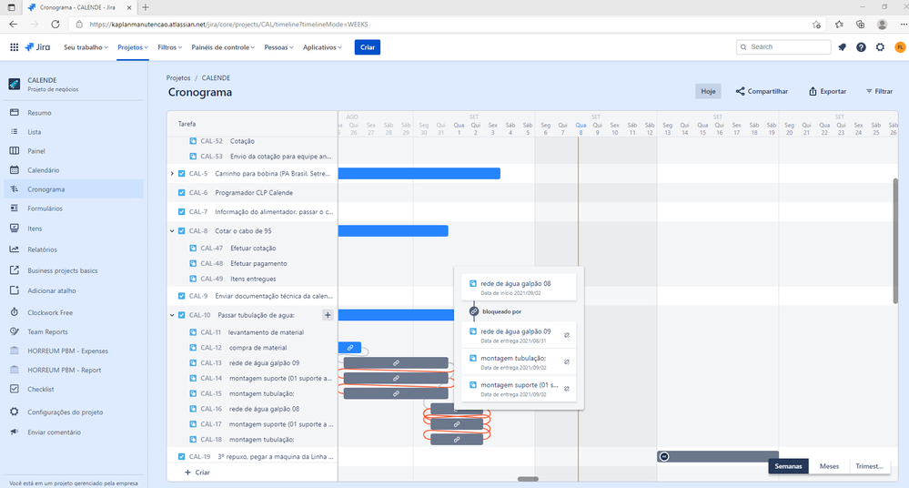

Hi Angelica. I tested it on Google Chrome, Edge and downloaded FireFox to test as per the screenshots, and it's still the same thing. I don't have any extensions on any of the browsers, I cleared the cookies and the problem persists. I was the one who created the board and I am the administrator of the entire project, but both me and my co-workers were unable to unlink, all the same thing happens, when I click on unlink it "flashes" and becomes linked again.

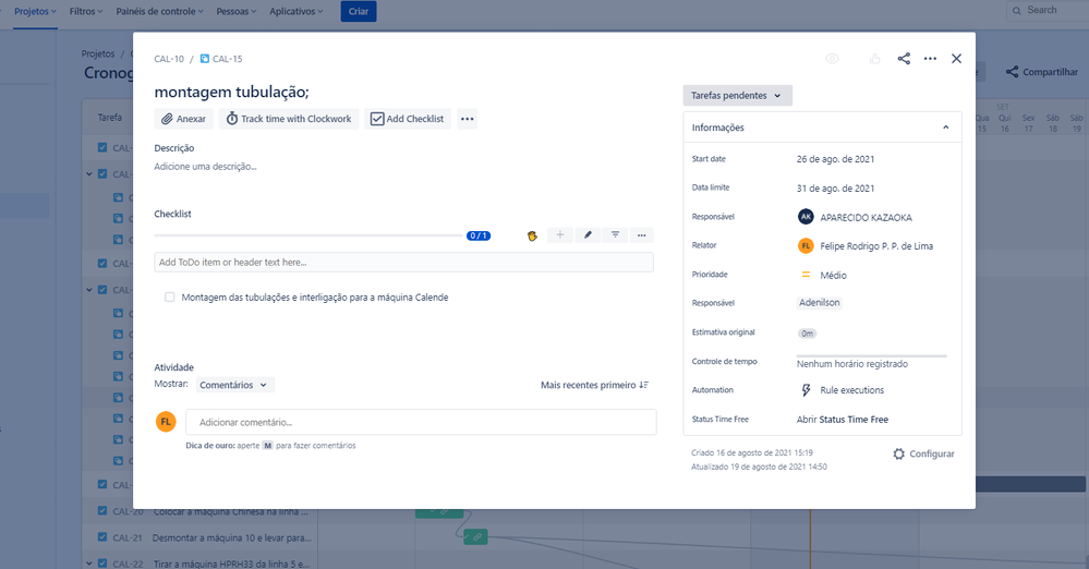

I didn't find any option to unlink when clicking on the ticket as the screenshot below, can you explain better, please?
ticket.pngAnyway, thank you so much for the answer Angelica.

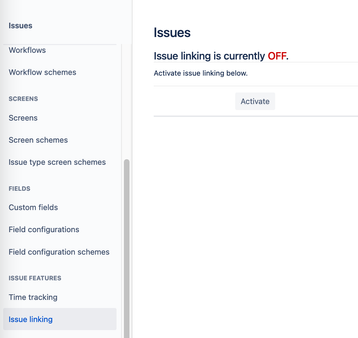

Checking the logs of your site, it returned the error below:
Error performing JWMUnlinkItemsMutation mutation. Operation: gira-jbus-RemoveJWMDependencyTimelineView, Errors: Vinculação do item está atualmente desabilitado.
Then, I linked some tickets on the timeline and disabled the issue linking feature, that’s when I was able to replicate the issue.
Please, go to Cog icon > Issues > Issue linking > Activate.
After that, you should be able to unlink the tickets.
