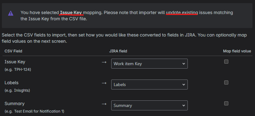

Issue key should appear when you are importing issues from the admin page.
Hope you are importing the issues by navigating to System and then External System Import.

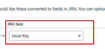

As mentioned, you need to have a column with Key of the issues and map this column for the Issue Key field when you're mapping your CSV file. Also, the Summary field needs to be present and mapped in your CSV.

Hi, you can only update work items using a CSV file from the "External system import" tool on the Jira admin settings, hence you need Jira administrator permissions. You CSV file must include at least these columns: Work Item Key, Summary and the columns you want to update:
From the "External system import" tool:

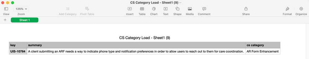

Step 1 - CSV file

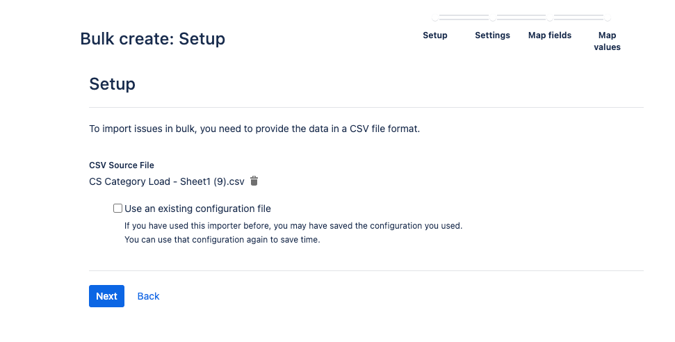

Step 2 - Loading the CSV

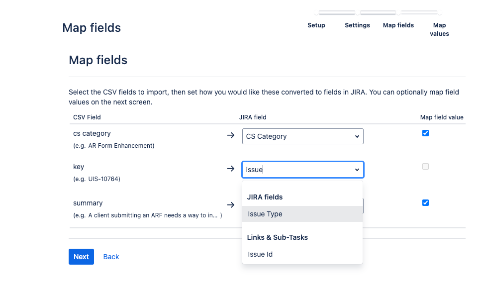

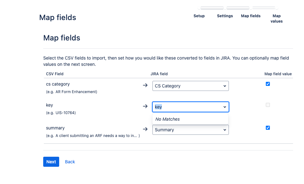

Step 4 - Mapping the fields
No Key option!
If searching "issue" - Issue ID is available. I created a different CSV file with Issue ID instead of Key and it didn't help.

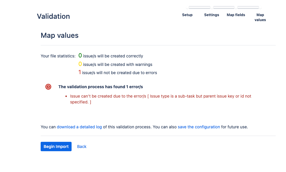

Step 5 - Validation
Error
This is another problem. If I include issuetype column into CSV then there is no error and Jira created new issues. it happens with both files with mapping IssueID and with Key which I cannot map due to no option in dropdown menu.
