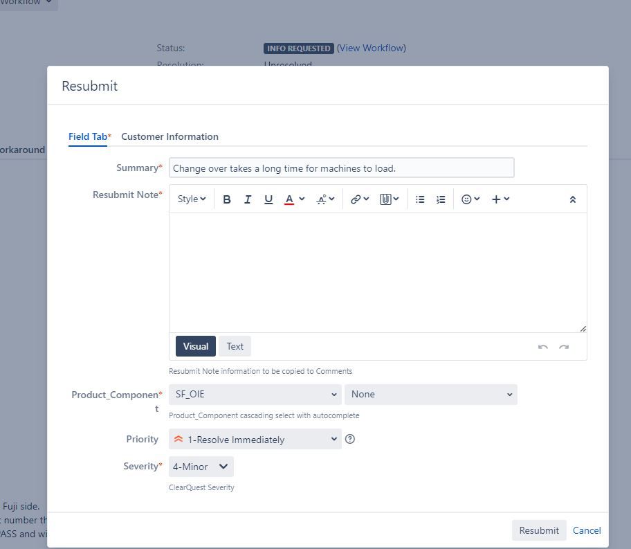

Resubmit note is a mandatory field which needs to be filled before changing the status of the issue, this is how it looks in the UI:
so it is expected that i also need to update this field in the Rest call . I know i am missing this part in the rest call I just need to know what exactly is the correct syntax to update this field at the same rest of updating the status if the issue.
