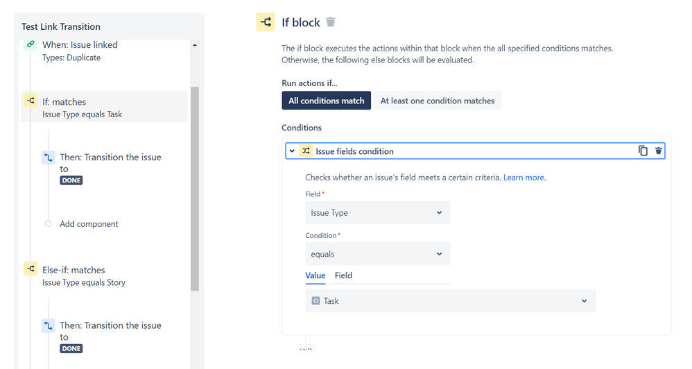

Hi Stuart,
You can try this Automation shown in the attachment.
Replace Issue Linked Type name , Status name and Issue Type name as per your requirement.
