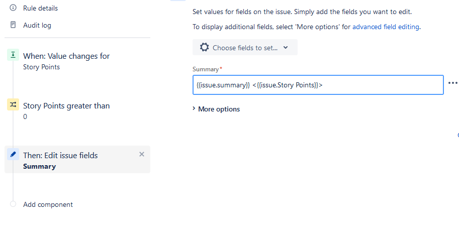

When user update the story points of an issue, that story points should be added to the Issue Summary and this we have done through the automation and it's working fine.
The problem is. after that automation triggers, if you update the story point field again, the results become something like "summary name <8.0> <5.0>". For the above example is to add a step before it creates the new summary to remove any references to previous story number points. So the number could be anything. Need to replace only the old story points with the updated one in the summary.
You could use substringBefore() first to truncate off any earlier sizing, and then add on the new story points string.

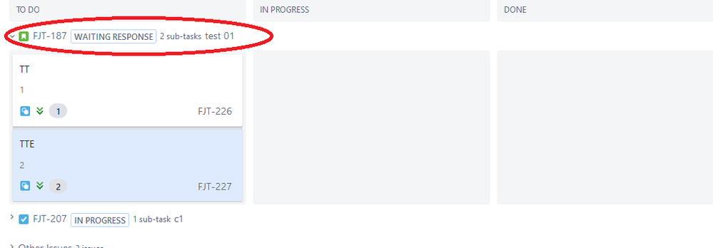

Story points are not getting displayed when the swimlanes are based on stories.
Eg-

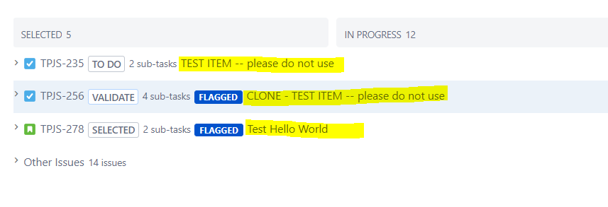

Samuel, is that a Company-Managed (classic) or Team-Managed (next-gen) project?
When I use swimlane by stories, I am still able to see the story summary at the top of the lane for company-managed.

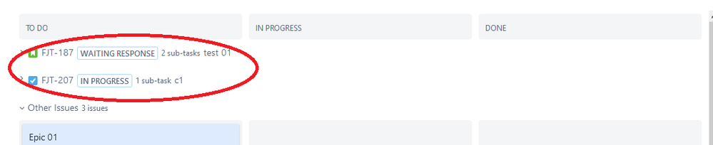

@Callum Carlile _Automation Consultants_ Still not getting displayed, It's getting displayed for the sub-task cards under the stories when the swimlanes are expanded.
@Samuel Prathipaty Is the Story Points field definitely on the screen associated with the parent tasks? I.e. when you click on one of the issues which isn't displaying the story points on the Sprint view, can you see the story points field within the issue itself?
@Samuel Prathipaty this is what I see for a company-managed project when using swimlanes by story. I have highlighted where I see the summary.
@Callum Carlile _Automation Consultants_ Yes. story points are associated to the screen and it's showing up on the detailed view. It showing up on the cards. we need SP to be displayed for the parent issue (FJT-187)
@Bill Sheboy Ohh no. Yes, summary is dispayed. I said story points are not getting displayed, that's the reason we choose to update the issue story points to the summary using automation.

Hi @Samuel Prathipaty , This won't be possible with your current setup, as like you say, you will always be adding the number onto the end of the summary (which may contain at least one reference to story points)... There is no way of adding a dynamic field within the Summary which updates as the other field updates.
You could set something up which copies the Summary into another custom field upon creation, and then each time the Story Points are updated you can set the summary to {{issue.Cloned Summary Field}} <{{issue.Story Points}}. This however is quite clunky, and you could very quickly run into issues whenever the Summary is manually changed.
