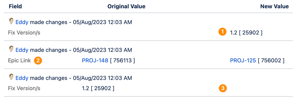

This is apparent when you look at the History for the issue:
❶ The Listener triggers first, and properly updates Fix Version/s from "none" to "1.2".
❷ Jira updates the issue and records the change to the Epic Link field
❸ Fix Version/s is reverted back to "none" 😞

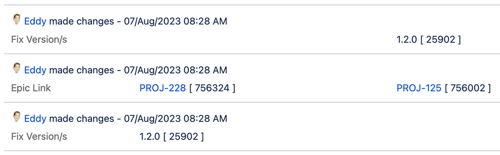

For completeness, I used the Edit button to change the Epic Link field in PROJ-153, and then clicked the Update button.
The History was updated with these three entries:

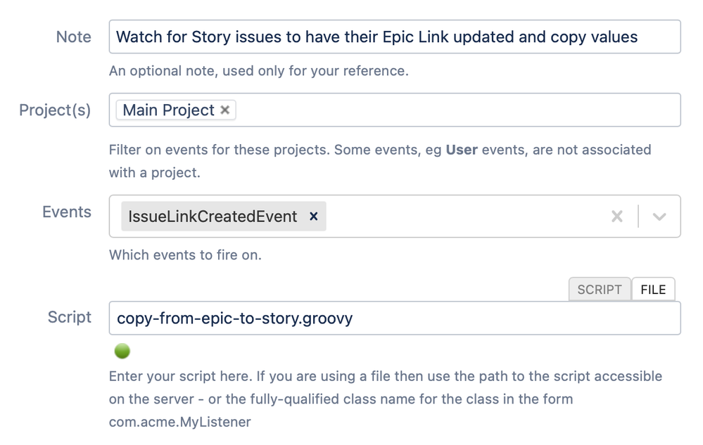

Here's how the Listener is configured:

Below is a screenshot of the Listener configuration:-
I hope this helps to solve your question. :-)
