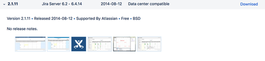

No worries. I am glad that you were able to have the problem figured out on your end. Since you mentioned that the root cause was related to the JIRA Calendar Plugin, I took a look at the version history of the add-on in the marketplace here and it shows that the version that you are on (2.1.11) is supported in 6.4.14. So, I do wonder why the plugin contributed to the issue:
Since you mentioned that you found a post related to it, can you share it here? I just want to make sure that the issue was indeed caused by the JIRA calendar plugin and not other plugins instead.
