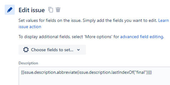

I just checked and this definitely works fine ... you don't need to create the "variable" so can find and edit within the same smart variable ...
{{issue.description.abbreviate(issue.description.lastIndexOf("final"))}}
FYI. Here's the result (adding "..." as expected - 4 characters before the last "final").
I hope this helps?
