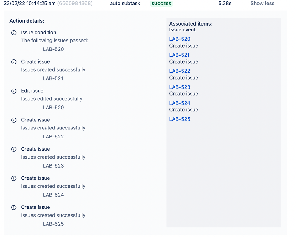

That is curious...just to confirm the conditions, would please post images of:
  • your current rule that does not work as expected,
  • the rule details section showing the settings, and
  • the audit log details for the execution?
And, are you using Jira Cloud or Jira Server/Data Center version?
Thanks!

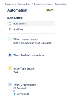

Note 1: The first screenshot doesn't show the hole rule but there are only more "Then: Create a new Sub-task" components so nothing different
Note 2: I already tried to add the "Re-fetch" in several positions but none of them worked

Bill Sheboy
February 25, 2022
Hi @Pauline Hild
Thanks for that information!  A few follow-up questions:
Is this rule in a specific project, or is it a global/multi-project scope rule?
Is this rule acting on a company-managed or team-managed project?
There appears to be an edit of the trigger issue (e.g. LAB-520) happening.  What is being changed?
You audit log apparently shows adding 5 subtasks.  What value is ending up in the Summary field for those issues created by the rule?
I do not understand why, but sometimes rules get "glitched" by the editor and do not work as expected.  Have you tried to recreate the rule from scratch to see what happens?
Bill
Pauline Hild
February 26, 2022
Hi Bill,
I thought I first try to recreate the rule from scratch and I couldn't believe but suddenly it worked! Maybe I should have done this first... anyway, thank you very much for your efforts to help me and the final hint that brought the solution.
