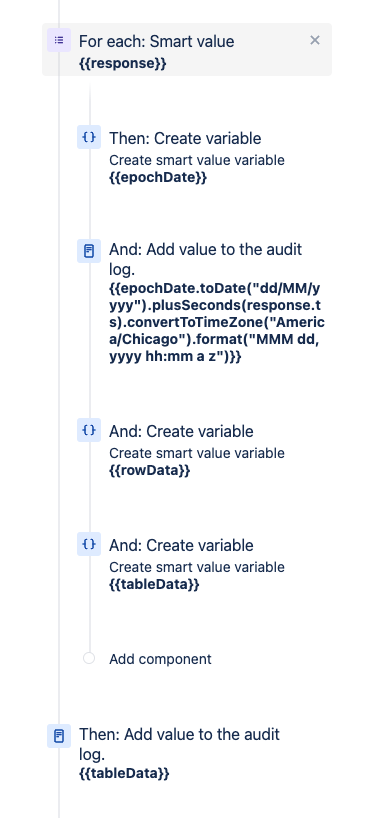

Hey @Bill Sheboy thank you for the welcome and the suggestion!
The branch suggestion worked great for using epochDate and the times returned from the webRequest in one smart value. The issue I'm running into now is building all of the iterations into one string that can be used in the body of a webRequest outside the loop so it is just sent once.
This would seem possible at first, given that I can use {{epochDate}} after the branch. But if I try to use {{tableData}} after the branch it appears to be null. Feels like there has to be a method I'm missing. Even if tableData did work after the branch ends, I need to find a different solution. It appears calling .concat(rowData) on the first pass while tableData is empty doesn't work so the first values will be missing.
Appreciate your help!

@Bill Sheboy I'm now realizing I'm probably running into the asynchronous behavior you mentioned. I tried creating a placeholder variable before the loop and concatenating each iteration to that. Then used the variable after the loop but it only ever contained values from the first loop.
Guessing there is no recourse here? Thanks again for the help!

Thanks for that info...this confirms a created variable cannot be used inside of an iterator.
One work-around is use the variable later using replaceAll(), like below.  Please simplify if you wish to use fewer variables  :^)
