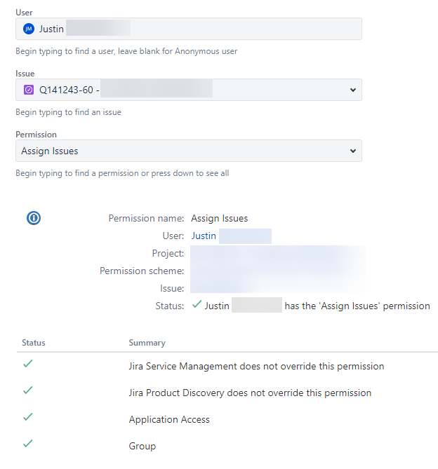

We have several users that cannot update the Assignee field. This has happened somewhat recently, and I do not know of any changes that have been made. The permission helper looks fine, but the user still receives "Assignee cannot be edited" when trying to assign issues. Below is one example of the permission helper screen:

When using the Permissions Helper there may be a link at the bottom to show failed conditions. Did your results include that link? Were there any relevant failed conditions?
Are the users able to edit other fields in the issue?
JV May 9, 2023
Yes it is hard to tell because the screenshot is all white, but there were no failed conditions for this user.
Editing other fields is restricted by design, so the check for "Edit Issue" fails in this scenario.

Do users that have the Edit Issue permission also have permission to Assign Issues? And does it work for them?
Are there any users that have the Assign Issue permission but not the Edit Issue permission that are able to assign issues?
I haven't had a chance to test it, but my theory is that the Edit Issue permission is required to support the Assign Issue permission.
JV May 10, 2023
I mean, yes... If I put the user into a group that also has Edit permissions, they can certainly assign and edit the whole issue.
As for any users with Assign but not Edit and can assign, I have tested with a handful of account and the results are consistent.
This begs the question, why is "Assign" a separate permission then? Also, this was functioning normally a couple weeks ago.

Another Community Leader (thanks @Esther Strom ) has confirmed that in their Jira Cloud environment it currently works as you expect; a user that has Assign Issue but not Edit Issues is able to change the Assignee field. They note that they have Release Tracks enabled for their system, so they may not have received all the updates you have gotten on your system.
