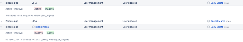

Hi @jason.heaney can you check audit log? It might give you more details about deactivating user
https://confluence.atlassian.com/adminjiraserver/auditing-in-jira-938847740.html
Good question.. How do I check that? Sorry, I am very new to Jira.

Hi @jason.heaney I would try to check the log files record in the time the user was deactivated. You can see the date&time of the user's deactivation in the audit log. Can you check it, please?
Hello @Martin Bayer _MoroSystems_ s_r_o__ I will have Contegix check that for us and report back.. Thank you
