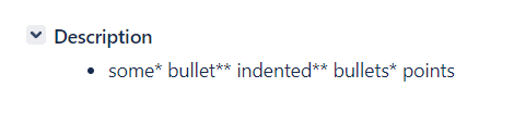

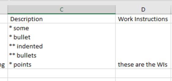

I am using the non-admin CSV import. For the description field, I can import bullet points by using asterisks, which get converted to bullet points. I haven't found a way to indent some of the bullet points, however (like the 3rd row in the list below). I've tried the following with no success:

The CSV importer respects the syntax provided by the Wiki Style renderer previously used on Jira Cloud. That being said, you must add the asterisks two times (**) to properly indent a bullet point in Jira Text fields through CSV, as displayed in the example below:
Also, the same logic should work to add more levels (***, ****, etc). Can you please confirm if it properly works for you?

When I try to use this formatting, it doesn't step it down to multiple lines. When I do a line or paragraph break, it doesn't create the bullets. Any idea how to fix that?

* bullet 1st level** bullet 2nd level (with no actual bullet points, just the asterisks)
Do you know what might have changed or I am doing incorrectly?
We solved the problem actually. We had accidentally marked the field as "map data". Undoing that checkmark during the import process resolved the problem.
I've tried the above & even unchecked the map data field. However it is still uploading it into JIRA as below:
*some
*bullet
*points
I've made sure the field is configured as a Wiki Style Render. Am I missing something ?
Ignore the above, apparently my formatting was incorrect. Note to others, you need to input a space in-between the Asterisk & the Text.
E.G:
* some
* bullet
* points
