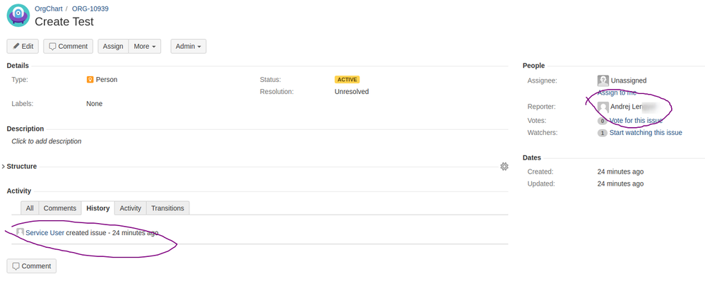

But this seems to be false. No matter which ApplicationUser you hand over to the method, it always uses the Context's LoggedInUser.
The workaround is to set the context's loggedInUser to the intended user before creating the issue by using this method.
I encountered this curiosity while debugging a script where an issue should be created with an automated admin user, but the transition button is pressed by a non-admin user.
So my question is: Is this intended, an Atlassian bug, or am I missing something.

//Both return "autoassist" as the Reporter and Creator:
logger.debug("Creator: " + newIssue?.getCreator())
logger.debug("Reporter: " + newIssue?.getReporter())

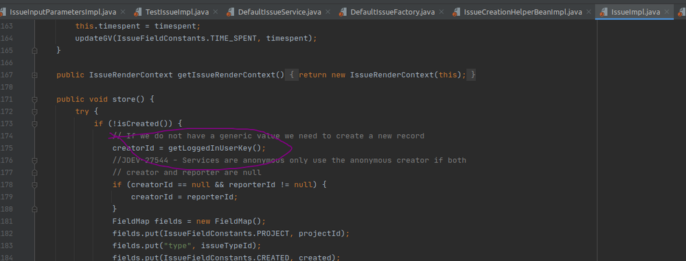

Hi @Joerg , it is interesting. I checked Jira source codes and it looks like setApplyDefaultValuesWhenParameterNotProvided might be the problem.
Short description:
public void populateDefaults(Map<String, Object> fieldValuesHolder, Issue issue) {
ApplicationUser remoteUser = getDefaultValue(issue);
if (remoteUser != null)
fieldValuesHolder.put(getId(), remoteUser.getName());
public ApplicationUser getDefaultValue(Issue issue) {
// The default value that should be set if the user cannot modify this field is the remote user's name
return getAuthenticationContext().getUser();
Can you try to call the method setApplyDefaultValuesWhenParameterNotProvided with false parameter?

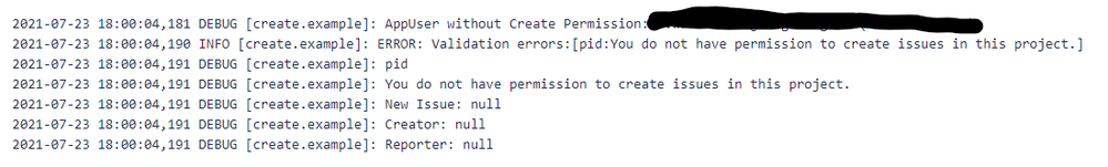

Did some test anyway:
adjusted the script. I removed the create permission in the project from the "appUser". Only the adminUser now has create permission there:

//ApplicationUser appUser = ComponentAccessor.getJiraAuthenticationContext().getLoggedInUser() //Non-Admin User
ApplicationUser appUser = userManager.getUserByName($userWithoutCreatePermissionInProject) //Random User without create permissions in the project
ApplicationUser adminUser = userManager.getUserByName("autoassist") //Admin User
//Setting loggedInUser to User without create permissions in the project:
ComponentAccessor.getJiraAuthenticationContext().setLoggedInUser(appUser);
logger.debug("AppUser without Create Permission: " + appUser)
String newSummary = "Create Test"
//creating with adminUser "autoassist":
MutableIssue newIssue = createIssue(adminUser, newSummary, issueService, logger)
logger.debug("New Issue: " + newIssue?.getKey())

CreateValidationResult createValidationResult = issueService.validateCreate(appUser, issueInputParameters1)
boolean isValid = createValidationResult.isValid()
Map<String, String> errorCollection = createValidationResult.getErrorCollection().getErrors();
if(errorCollection){
logger.info("ERROR: Validation errors:" + errorCollection);
for (String errorKey : errorCollection.keySet()) {
logger.debug(errorKey)
logger.debug(errorCollection.get(errorKey))
log.error("Creator: " + newIssue?.getCreator())
log.error("Reporter: " + newIssue?.getReporter())

So basically you are confirming that the permissions are run against the loggedInUser then (unless there is none, then reporte is used)?
I wonder what is the point of the parameter in the validate and create methods of IssueService then? Is the user in parameter used to check permissions, but when it comes to storing the issue, there is an additional permission check for the creator (normally LoggedInUser), which has to have the create permission as well?
If so, then I wonder if this is a bug or oversight by Atlassian, because it is definitely confusing.
I guess my workaround would be (if the currently loggedInUser has no permissions, and I need to create the issue with another user) to:
