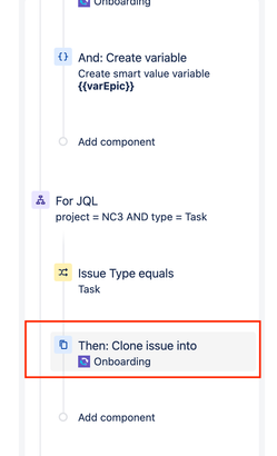

Here is an example of mine to illustrate

Hey @Jimmy Seddon thanks for your help.
Looks like my issue was due to the branch - i was trying to pass variables between branches (not allowed)!
