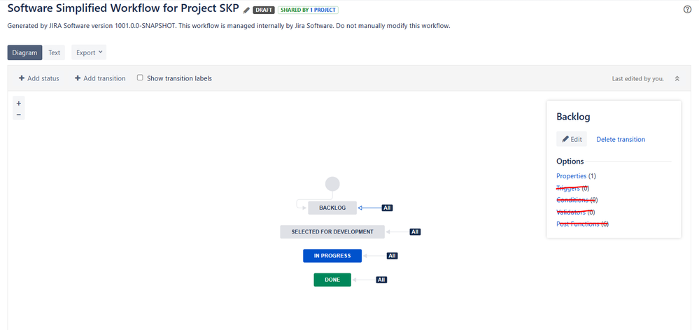

You are saying in this screen -
that you only see Properties, and not any of the other options?
Please can you check / confirm if this a team-managed or a company-managed project? I just learned that this configuration is not possible in a team-managed project -
Solved: Cannot add a post function to a jira web workflow (atlassian.com)
Please give me your feedback and either I or someone else will try to help.

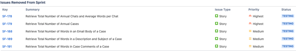

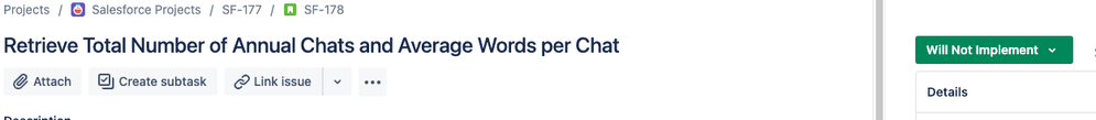

Per the screenshots below, the status is showing “testing” when these issues were removed from the sprint. However, in the second screenshot, for these issues' status’ we had selected “Will Not Implement”. Is this issue derived from the change I made initially?
