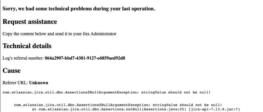

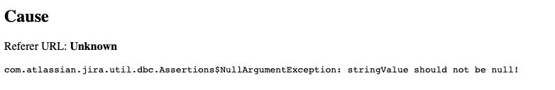

Trifon Anguelov August 30, 2020
Cannot load the URL from the browser:
the custom field "EPC ID" is cf[29315]
The intended query is:
issues/?jql=cf[29315]=10567793
still getting the error:
If I use JIRA search bar, it works but not from a browser by using the URL: issues/?jql=cf[29315]=10567793
Adding more text from the error message in Chrome and Safari:
Sorry, we had some technical problems during your last operation.
Request assistance
Copy the content below and send it to your Jira Administrator
Technical details
Log's referral number: d3a0e0fa-3e6d-44ed-9c15-1374a6e72f44
Cause
Referer URL: Unknown
com.atlassian.jira.util.dbc.Assertions$NullArgumentException: stringValue should not be null!
at com.atlassian.jira.util.dbc.Assertions.notNull(Assertions.java:25) [jira-api-7.13.8.jar:?]
at com.atlassian.query.operand.SingleValueOperand.<init>(SingleValueOperand.java:20) [jira-api-7.13.8.jar:?]
at com.atlassian.query.clause.TerminalClauseImpl.<init>(TerminalClauseImpl.java:90) [jira-api-7.13.8.jar:?]
at com.atlassian.jira.issue.customfields.searchers.transformer.MultiSelectCustomFieldSearchInputTransformer.getClauseFromParams(MultiSelectCustomFieldSearchInputTransformer.java:77) [classes/:?]
at com.atlassian.jira.issue.customfields.searchers.transformer.AbstractCustomFieldSearchInputTransformer.getSearchClause(AbstractCustomFieldSearchInputTransformer.java:71) [jira-api-7.13.8.jar:?]
at com.atlassian.jira.components.query.DefaultSearcherService.generateQuery(DefaultSearcherService.java:257) [?:?]
at com.atlassian.jira.components.query.DefaultSearcherService.searchWithJql(DefaultSearcherService.java:158) [?:?]
at sun.reflect.GeneratedMethodAccessor3740.invoke(Unknown Source) [?:?]
at sun.reflect.DelegatingMethodAccessorImpl.invoke(DelegatingMethodAccessorImpl.java:43) [?:1.8.0_222]
at java.lang.reflect.Method.invoke(Method.java:498) [?:1.8.0_222]
at org.springframework.aop.support.AopUtils.invokeJoinpointUsingReflection(AopUtils.java:302) [spring-aop-4.2.5.RELEASE.jar:4.2.5.RELEASE]
at org.eclipse.gemini.blueprint.service.importer.support.internal.aop.ServiceInvoker.doInvoke(ServiceInvoker.java:56) [?:?]
at org.eclipse.gemini.blueprint.service.importer.support.internal.aop.ServiceInvoker.invoke(ServiceInvoker.java:60) [?:?]
at org.springframework.aop.framework.ReflectiveMethodInvocation.proceed(ReflectiveMethodInvocation.java:179) [spring-aop-4.2.5.RELEASE.jar:4.2.5.RELEASE]
at org.springframework.aop.support.DelegatingIntroductionInterceptor.doProceed(DelegatingIntroductionInterceptor.java:133) [spring-aop-4.2.5.RELEASE.jar:4.2.5.RELEASE]
at org.springframework.aop.support.DelegatingIntroductionInterceptor.invoke(DelegatingIntroductionInterceptor.java:121) [spring-aop-4.2.5.RELEASE.jar:4.2.5.RELEASE]
at org.eclipse.gemini.blueprint.service.util.internal.aop.ServiceTCCLInterceptor.invokeUnprivileged(ServiceTCCLInterceptor.java:70) [?:?]
at org.eclipse.gemini.blueprint.service.util.internal.aop.ServiceTCCLInterceptor.invoke(ServiceTCCLInterceptor.java:53) [?:?]
at org.eclipse.gemini.blueprint.service.importer.support.LocalBundleContextAdvice.invoke(LocalBundleContextAdvice.java:57) [?:?]
at org.springframework.aop.framework.JdkDynamicAopProxy.invoke(JdkDynamicAopProxy.java:208) [spring-aop-4.2.5.RELEASE.jar:4.2.5.RELEASE]
at com.sun.proxy.$Proxy3430.searchWithJql(Unknown Source) [?:?]
