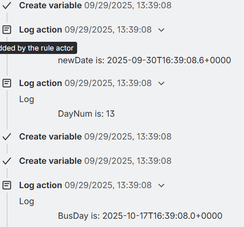

I checked the implementation you suggested and hit the same problem but after testing several times, I saw that the problem was the shortDate format you are requesting to function,  if you eliminate that part, the function would return a date which is field type used for the Date operation.
So, to summaryze, use:
NewDate: {{now.endOfMonth}}   instead of   NewDate: {{now.endOfMonth.shortDate}}
The function you are using worked correctly for me.
Kindly give it a try and let me know if you need further help.
