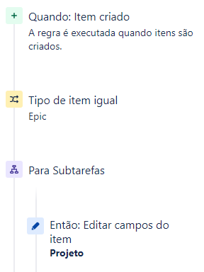

I'm an English speaker so please confirm my understanding...
Based upon your screenshot, it looks like when an Epic is created, you're branching into sub-tasks and editing the items.
If my understanding is correctly, this is not going to work because when you create an epic, it will not yet have any tasks/sub-tasks yet. I would recommend that you configure a rule like this:

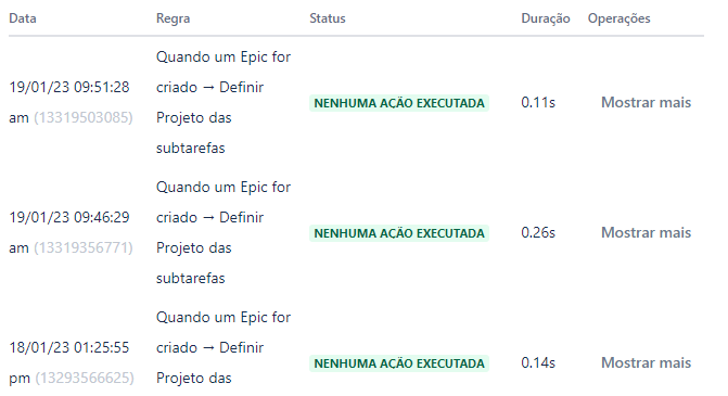

Yes, that's exactly it, but that rule you gave me didn't work, I've tried replacing it with: {{issue.parent.Epic Link}}, it didn't work either.

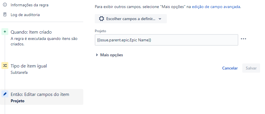

Sorry it should be this (just validated in my test environment):
{{issue.parent.epic.Epic Name}}
The "no actions performed" tells me that it's triggering, but not passing the condition so it is not recognizing that the trigger issue is a sub-task (you'll be able to confirm this by expanding one of those audit log entries).
I can confirm this works in my test environment.
Lastly, to confirm my understanding, you are creating these sub-tasks manually. If that's correct, the rule looks properly configured. However, if you have another rule generating the sub-tasks, you'll need to make sure Allow Rule Trigger is checked on the Rule Details screen.
I hope this helps.
I actually ended up forgetting to check the option to allow a rule to trigger the other. Now it worked fine!
