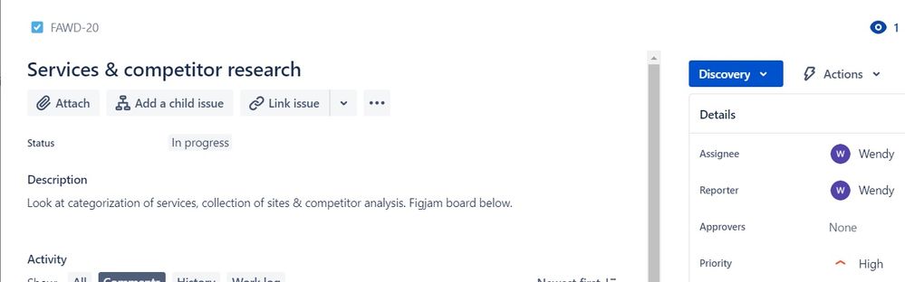

Hi, I'm new to Jira and have been setting up my project but came across an issue. When I first started the project, I changed the existing 'To Do' 'In Progress' 'Done' columns to be my own headings (planning, discovery, set-up, build etc.). Then added a status within each issue. However, on the summary tab, 'Done' has 0 in it which I think I've worked out is because I changed the headings, but I want it to recognise the status field I set up within each issue. Is this possible? Or am I using the wrong template?

In your original post you indicated some confusion as to whether you are using Jira Work Management or Jira Software. Based on the screen image you provided you are working with a project created from a Jira Work Management template.
At the bottom of the panel on the left you should see a message that includes either "team-managed" or "company-managed". Which do you see? I suspect that it might be "team-managed". This is an indication of what I call the "architecture" of the project and determines who can make customization (like adding custom fields or changing the available issue Status values) and some other functionality options.

Hi @Trudy Claspill Thank you for your reply. I have managed to edit my workflow to add additional status columns for each phase of the project so it is now displaying how many are 'done' in the summary tab.
I see 'Team-managed' bottom left, hopefully that's the correct setting as I do want to be able to add additional columns.
Thank you for your help, I think I'm sorted now with the correct settings for my project. I'm loving getting to know Jira, it's so useful :)

1) The columns in the board - when I first opened the template these columns were labeled 'To do' 'In Progress' and 'Done' and I changed them to what you see here (Pre-planning, Discovery etc.) Not sure if these headings are what feeds the 'Done' box on the summary tab (third screen grab)?
2) An example of an Issue. I have added a status field above the description and was hoping that could feed the 'Done' box on the summary tab.
3) The Summary tab. The top left shows how many tasks are done, which say's 0. I am guessing it's because I changed the column headers? How can I get this to use the status field shown in the second screen grab?
I tried to add status columns back in and thought i could move a task to that column when done, regardless of which phase of the project it came from, but it wouldn't let me as it said there was already one there?!
