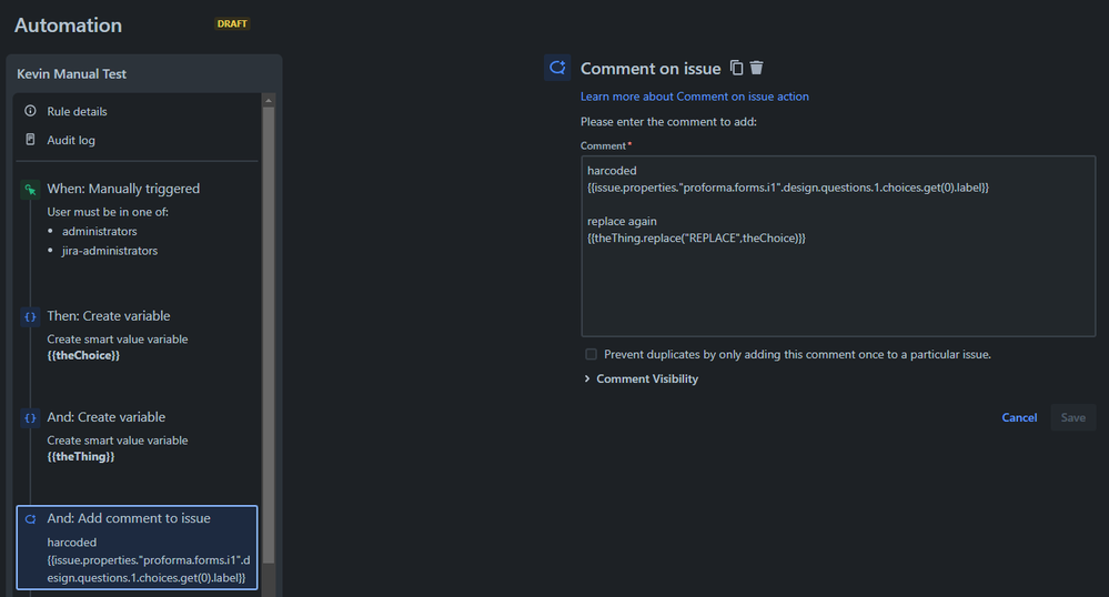

I can't seem to get the replace to work for me and I can't figure out what I'm doing wrong.
Here is my one variable:
Here is a second variable that contains my Jira Smart value. I put the word REPLACE in there for what I want to replace later.
I then try to use the following:
{{theThing.replace("REPLACE",theChoice)}}
Which I would hope would result in
{{issue.properties."proforma.forms.i1".design.questions.1.choices.get(0).label}}
But it does not work.
Anyone know what I'm missing?

Kevin Christmann October 13, 2023
@Bill Sheboy sure thing! (I just noticed my one screenshot didn't come through in the previous post.
My rule is very simple right now as I'm just trying to test out this specific replace functionality before I put it into my real purpose.
My rule just...
1. Triggered manually
2. Sets the first variable to 1
3. Sets the 2nd variable as seen
4. Comment on the ticket with my attempt at the replace (so I could see if it worked)

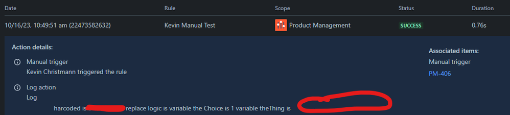

And here is the audit log. It makes the comment on the ticket, but only the top, hardcoded line works. The replace does not.
Bill Sheboy
October 13, 2023
If you write {{theThing}} to the audit log, what do you observe?
What is being written to the comment added?
Side note: I do not know which version of Jira you are using, but if you are using Jira Cloud and you are on Standard or Free license, consider only writing to the audit log for test rules, rather than writing to issues with comments.  Otherwise that will start counting against your limits next month.  Please look here for more information: https://community.atlassian.com/t5/Automation-articles/Introducing-our-new-packaging-model-for-Jira-Cloud-Automation/ba-p/2446099
Like • Tomislav Tobijas likes this

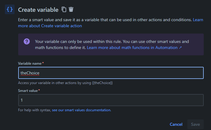

Kevin Christmann October 16, 2023 edited
@Bill Sheboy ah great idea! I never thought of that! I'm on Cloud Premium.
So it appears my issue is the variable {{theThing}} is not getting set. It doesn't like me passing in a smart value.
Is there a way for me to force it to accept a literal string?

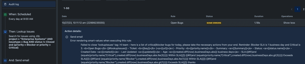

Dyyan
October 27, 2023 edited
[Resolved] Hi - I'm unable to crack this error, and would appreciate any help/guidance for the fix:
Audit Log view:Screenshot 2023-10-27 at 10.47.17.png
Thanks & Regards,
Dyyan
Tomislav Tobijas
October 27, 2023
If I may jump in here @Dyyan
👀 By the look of the logged error message and the content on the screenshots, aren't you missing one {{/}} in the end (closing of {{#lookupIssues}} smart value)? So basically, just add this string before the "thanks" text.
Like • 2 people like this
Dyyan
October 27, 2023
ah, my bad. Thanks so much, @Tomislav Tobijas !
