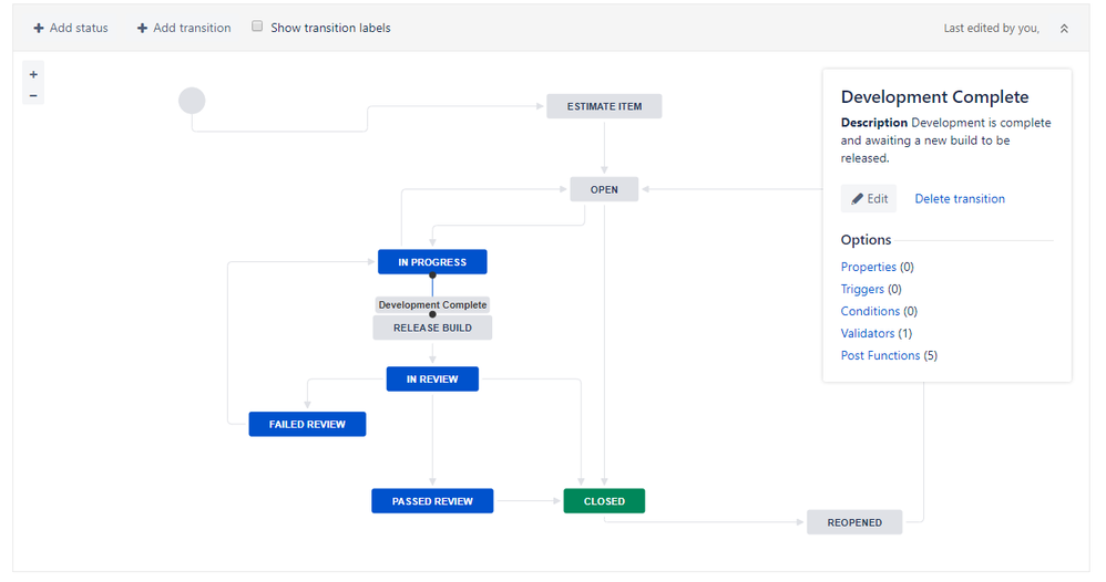

workflow:

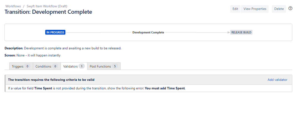

validator:

Also, I don't necessarily need the time logged to be filled out during the transition, just need it filled out before the 'development complete' button can be pressed. Maybe I'm going about it the wrong way?
understood. the current validator requires that the user log time when transitioning. For this to work you need to have the transition screen actually present 'log time'.
I think what you want is to ensure that time spent is not empty if the user transitions?
If so try the following on the transition:
or something similar
Awesome, that's it! Thank you so much!
But say I did want the time spent screen to pop up on transition, how do you do that?
Thanks again!
Basically you can build a new screen or edit the one that is currently being used (but avoid this is you are sharing the screen w/ other projects). Then edit the WF, double-click the transition and assign the screen to that transition. This will ensure that the screen pops up w/ the desired fields and you can make those fields required for that screen.
