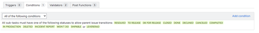

Just to add to what @Trudy Claspill describes above. You can add a condition directly in the workflow that all Sub-task needs to have a certain status before allowing the transition.
The drawback is that the user don't get any error message, the transition is just unavailable until the conditions are met which might cofuse users.

Mahnoor Arshad September 4, 2025
@Staffan Redelius
I have tried this option, however it will hide the transition from the user which is something I do not want in the process. And it would be a nice to have an error message appear.

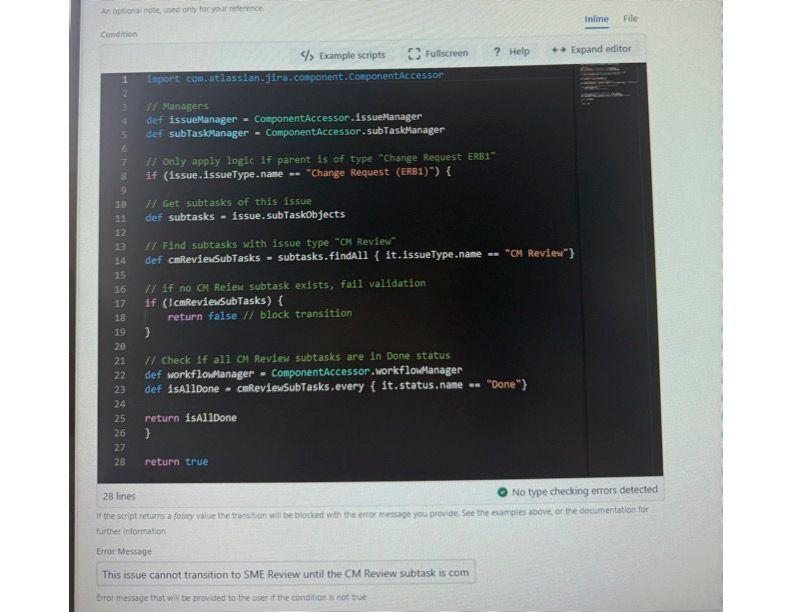

Hi @Trudy Claspill
I have Scriptrunner. I have written a simple scripted validator to help achieve this however it does not seem to be executing properly.

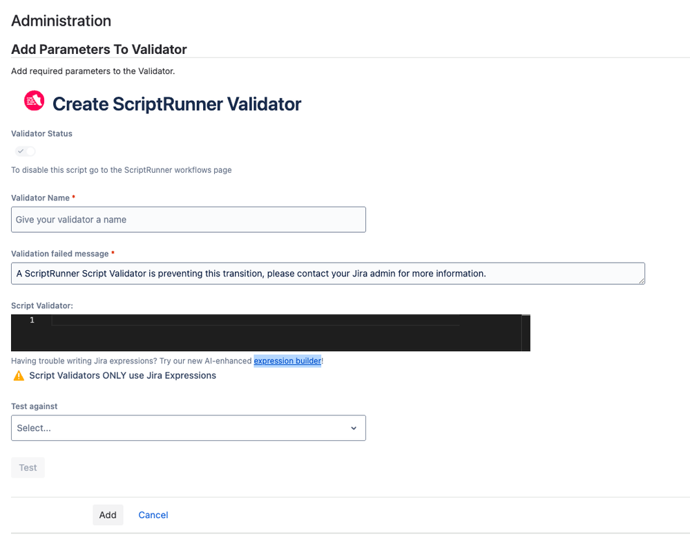

Trudy Claspill
September 4, 2025
Hello @Mahnoor Arshad
Thank you for that additional information.
The tags on your post indicate that this question concerns Jira Cloud.
Can you confirm that this is for Jira Cloud versus Jira Data Center? The screen I have in my Jira Cloud instance for adding a ScriptRunner Scripted Validator to a workflow does not look like the image you provided.
Notice that mine has the field for the message above the scripting area.

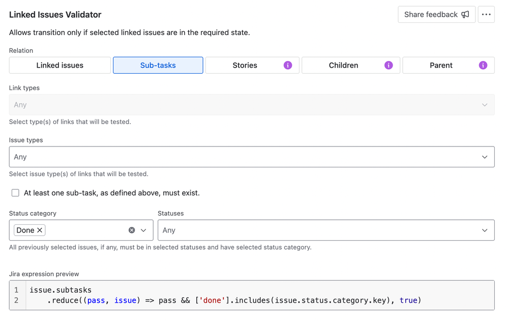

Matteo Vecchiato
September 3, 2025
Hi @Mahnoor Arshad .
Thank you for your question. Please consider the following doc from Adaptavist: https://docs.adaptavist.com/sr4jc/latest/features/workflow-extensions/jira-expression-examples  with Jira expressions and groovy script.
Other way is to "revert" the status through automation, but after have changed the status.
Hope it helps
