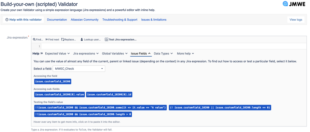

What is the custom field type of customfield_12308? Is it a single-select field or a multi-valued field (e.g. Checkboxes)?
Also, is "None" (in your case) an actual "Option" of the custom field, or do you mean it as "no value selected"?
Darryl Lee - CCC
July 7, 2020
Hi David - it's a multi-valued Checkbox field. "None" is an actual option.
Like Tyas Iglecias likes this
David Fischer
July 7, 2020
Then issue.customfield_12308.value is invalid, since issue.customfield_12308 returns a List of values, as shown on the Issue Fields help tab below the editor. Please use that help tab to insert the correct Jira expression for your custom field.

David Fischer
July 8, 2020
You cannot use include with multi-valued fields. The correct syntax to check multi-valued fields such as Checkboxes is shown on the Issue Fields help tab:
In your case, you'd want:
!!issue.customfield_12308 && issue.customfield_12308.some(it => it.value == "None")
And the opposite test would be:
!issue.customfield_12308 || !issue.customfield_12308.some(it => it.value == "None")
