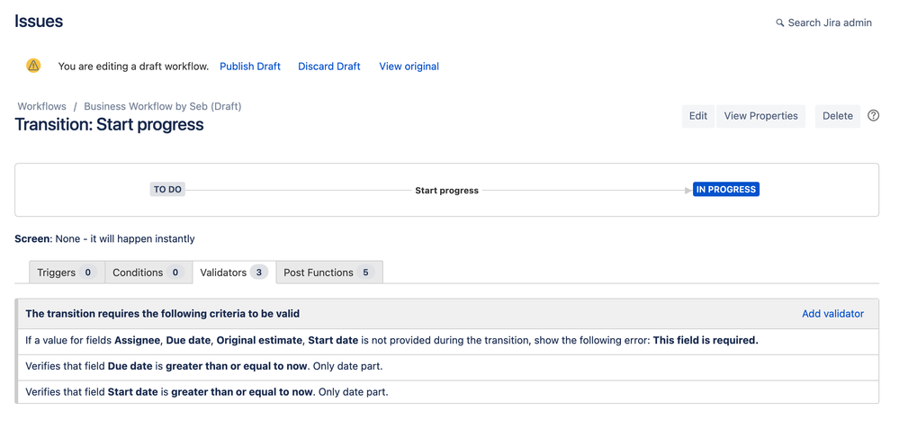

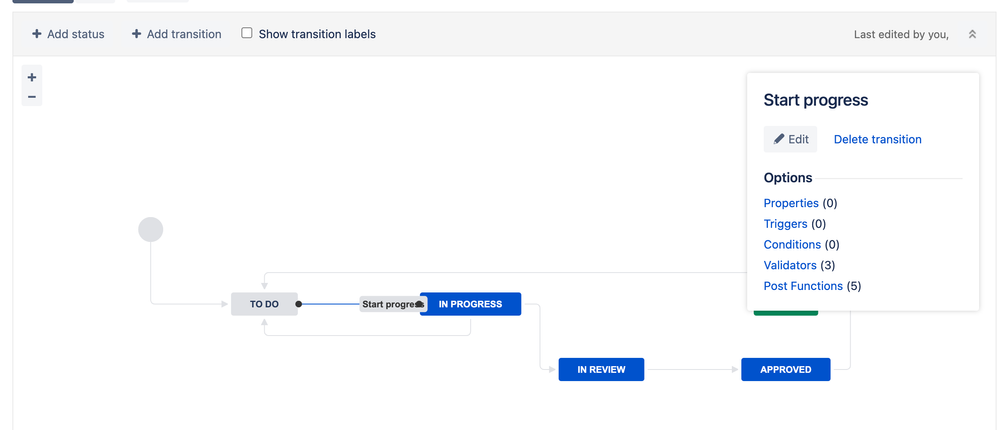

My transition from To Do to In Progress is simple, with only 3 validators:
  • If a value for fields AssigneeDue dateOriginal estimateStart date is not provided during the transition, show the following error: This field is required.
  • Verifies that field Due date is greater than or equal to now. Only date part.
  • Verifies that field Start date is greater than or equal to now. Only date part.
Sebastijan Bauman March 15, 2023
Screenshot 2023-03-15 at 14.30.27.png Screenshot 2023-03-15 at 14.30.36.png Screenshot 2023-03-15 at 14.31.02.png
