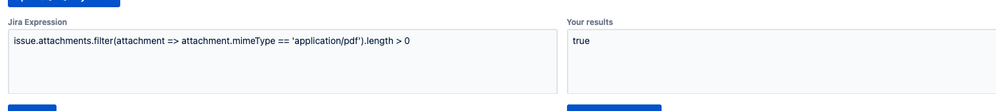

I also tried with a filter option that actually works on the Expression Tester but on the fast-track condition doesn't:
021-06-09 12:58:10.292 ERROR - startup failed:
Script1.groovy: 1: unexpected token: > @ line 1, column 38.
   issue.attachments.filter(attachment => attachment.mimeType == 'application/pdf').length > 0
1 error
2021-06-09 12:58:10.309 ERROR - Class: com.adaptavist.sr.cloud.workflow.FastTrackIssue, Config: [className:com.adaptavist.sr.cloud.workflow.FastTrackIssue, uuid:71369c1f-0147-4c52-b5de-899a697c2046, enabled:true, executionUser:ADD_ON, condition:issue.attachments.filter(attachment => attachment.mimeType == 'application/pdf').length > 0, description:, additionalCode:
, comment:Attachment is mandatory, please review, transitionId:101, transitionName:Back to Hiring Manager, accountId:XXXX]
