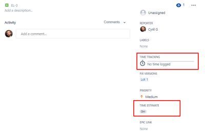

I (try to) use the Time tracking in JIRA Cloud, but have a lot of difficulties with the current version:
- there is a "new view" for issues.
On this new view, I have a field "Time tracking", where I can add a time log, and a field "Time estimate" (which is sometimes also called "Original estimate" or just "Estimated").
Unfortunately, on this view, I cannot have the "Work log" view that allows me to modify and check past time logs.
So, it is one of the reasons I had to switch back to legacy issue view.

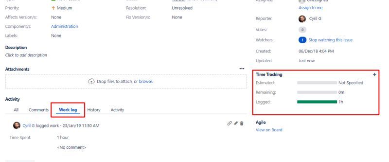

- Problem: on legacy view, I can add a time log, and see the "Work log" to change the previous time logs, but the field "Time estimate" doesn't appear anywhere. When I add a time log, the "Estimate" field appears but cannot be changed.
Quite tricky...

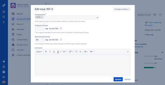

I also had to disable the new issue view because of the lack of worklog options - they're regularly rolling out new features so we should be getting additional ones soon. However I am able to to edit the time estimate of an issue:
  • when logging work:
  • or when editing the issue:

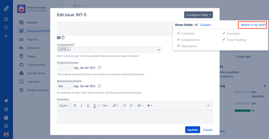

If you can't edit the estimate when modifying the issue, you can use the "Where is my field?" feature to understand why the Time tracking field is missing:

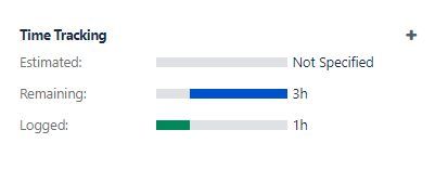

The "estimate" that you get, when you input a time log, is a different field than the "original estimate" (I know, it's a bit complicated...).
For instance, if you set "3h" remaining, and log "1h", you will have the following display, and you can see the "original estimate", that is labelled here as "Estimated", is "not specified".

When I use "Where is my field?" with "Estimate", I get nothing except "Story point estimate", and when I input "Time tracking", I get:
"The 'Time Tracking' field should be present on the form you are viewing"
BUT you gave me a hint in your answer!
I can use the "Edit" button on the issue, it displays the same form as the creation form, which HAS the "Original Estimate" field! I can change this field here!
I forgot about it, because you don't have the "Edit" button in the new view of the issues.
Thanks, it resolved my problem!
In summary:
To set an original estimate in the legacy view, you have to click on the "Edit" button of the issue.
